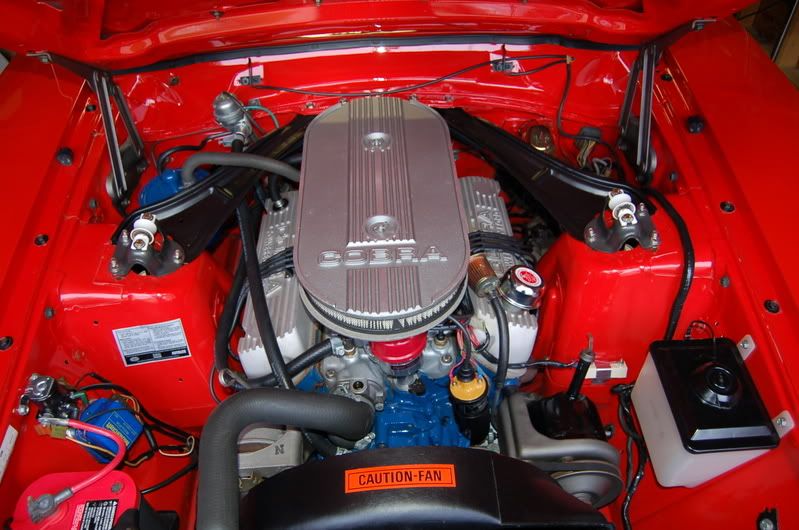

    As stated, solder and heat shrink tubes are the best method. For the factory look, check with vintage Mustang warehouses for a product called wire wrap. It looks like electrical tape, but does not have the adhesive-same as used by the factory. The adhesive in electrical tape gets gooey and makes a mess in a hot engine compartment over a period of time. A dab of RTV or weatherstrip adhesive at the end of your wrap will secure it nicely.
    The wires in this pic are wrapped with it.
    Seth
