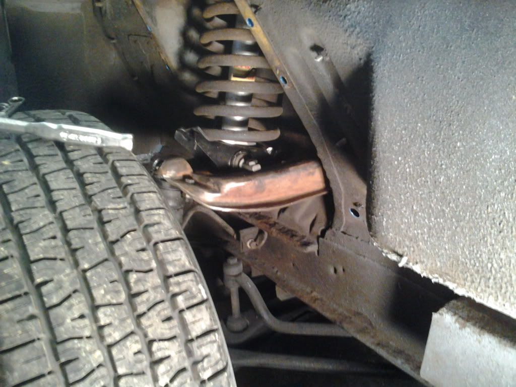

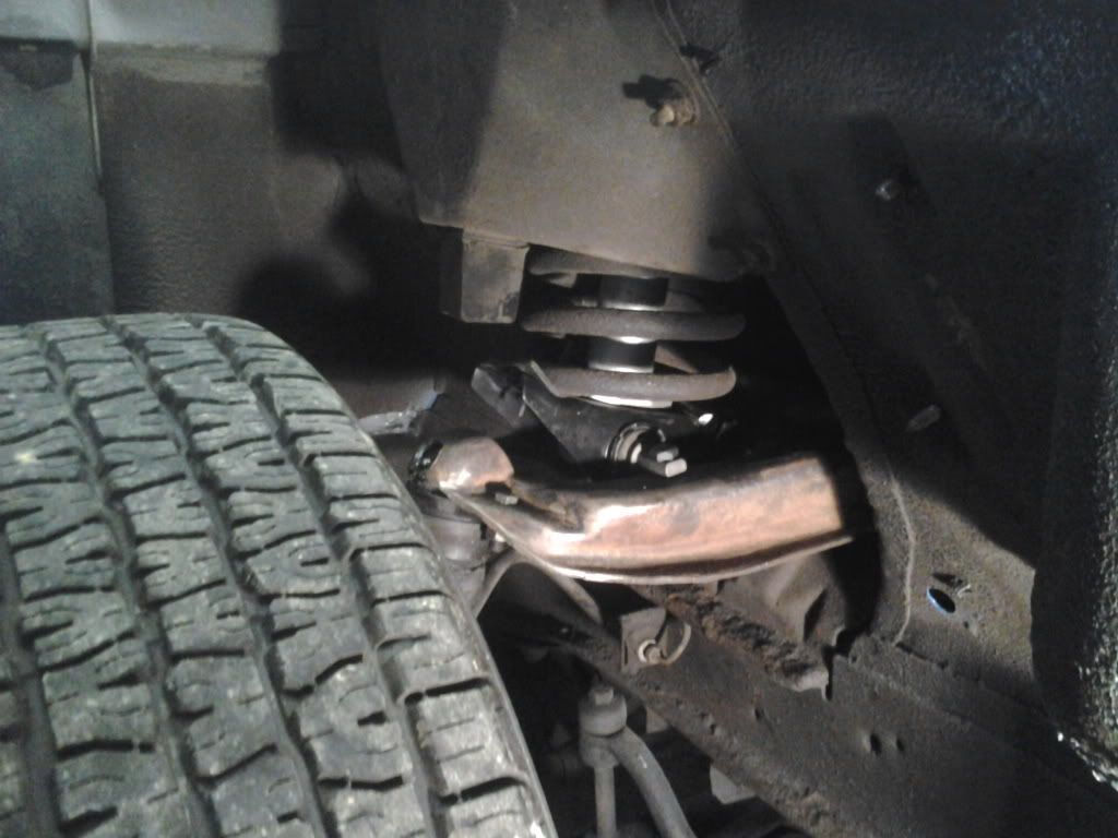

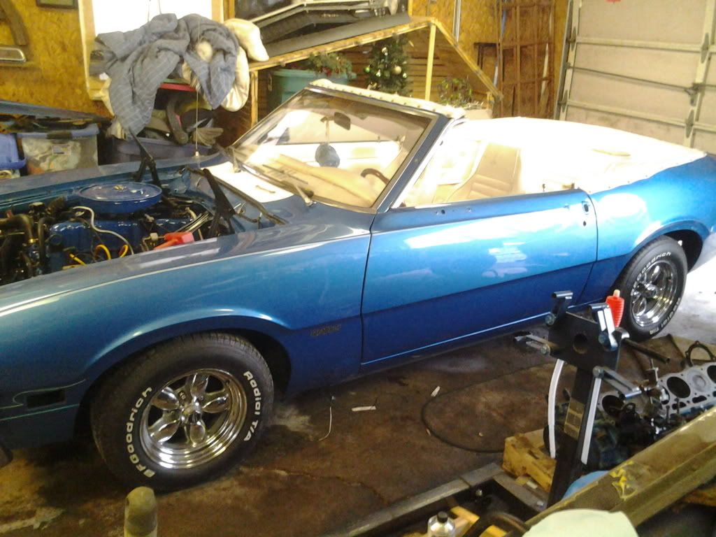

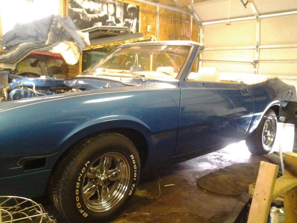

    I was going to repair some rust in the left fender and repaint under the hood since it was all off the car. I bailed on that plan and started putting the body back together. I will just have to pick at it a little here and a little there while I have time. The front end is sitting a little lower than I wanted it, but I like how the tire fills up the wheel well now. I think the plan is going to be to lower the rear an inch, maybe 2 and it will be good to go. I was ok with the way it rode yesterday, but I just added a few hundred pounds to the nose that may affect it now.
    Here are a couple pics of the days work.
    This is how the spring and control arm look.
    This is with the cover on. Looks like I have about 2 and a half inches before I hit the bump stop.
    Here is how it sits with most of the body back on. All thats missing is the hood and grill.
