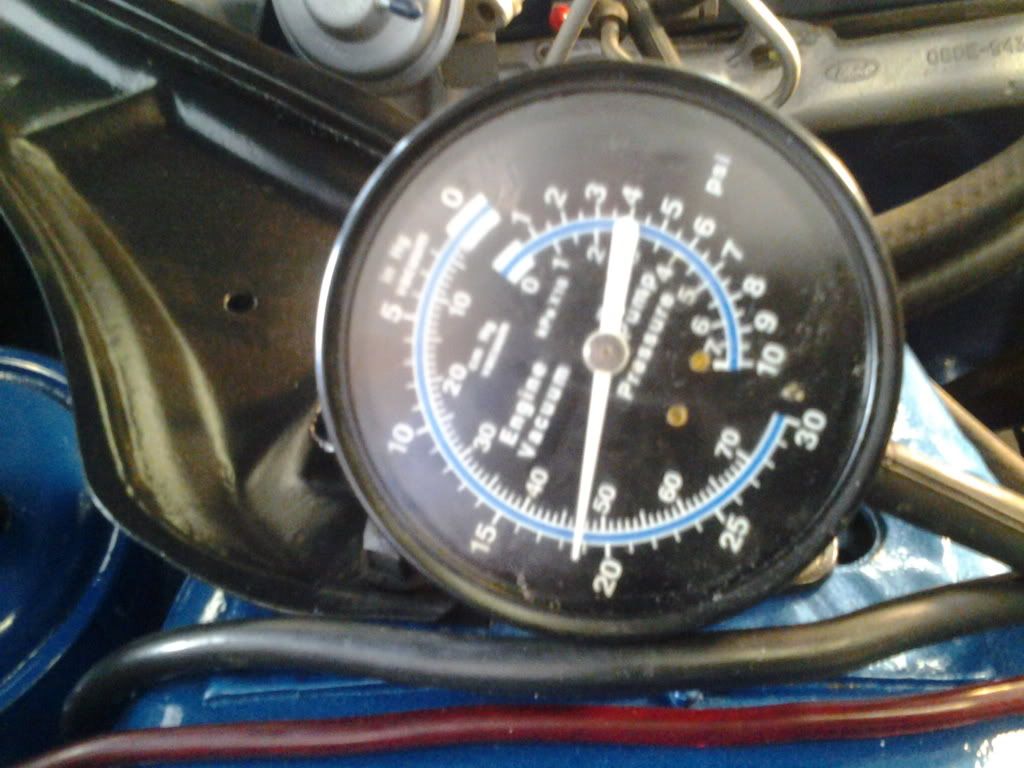

    Spent the better part of the day tending to things in the yard. Since I was a good boy for doing that, I felt it was ok to play with the car for a bit. I pulled the carb and DSII out of the 76 parts car. The carb tag is something like E0DE, and not an rbs like I thought. Not sure what it is really, but I put it on and fired it up. It ran but not great. Only had an inch of throttle and my breather wouldn't fit it, so I took it back off. I was about to put the 200's yf back and I glanced over at the yf that came off the 250 that I had rebuilt and tried first. I thought, what the heck, let's try it again since I messed with the timing the other day. What do ya know, it ran great! Still vibrates a lot in gear when stopped but this is the first time I noticed a difference from my 200. I still need to play around with the info I learned about recurving the distributor, but heck, great improvement.
    I thought that since I put the shorter carb back on that I could close the hood with my breather on it....wrong! What the $^$%@^! I had to remove my pretty FORD nut and put a regular bolt in and it closes, but it sure is close.
    I do have an issue with 2 noises that I'm hearing. One I hear when I start it, the other I hear when I make a U turn at the end of my road and get on the throttle. The noise I hear when I start it sounds like the fan dinging off a belt or something. Only one or two dings and it's gone. It doesn't always do it. The other noise I thought was a tire rub, but that's not it. It's a rapid clicking sound that I want to say is coming from the tranny. It's hard to tell exactly. The exhaust is so close to the body and the drive shaft that it could be related. Will have to wait until that's fixed to be sure. I don't think either noise is anything serious.
    Here is a pic of the vacuum I'm pulling currently.
  14. mojo
    5,279
    836
    Looks like a nice vaccum reading. Ur vibes might be from a carb problem. I thought it cud/might be vac leak, until I saw that vac reading.
