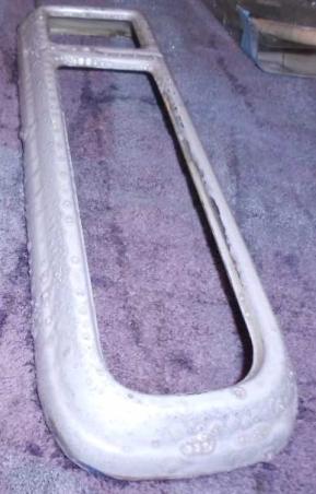

    I need my anodized aluminum (rear window trim & tail light bezels) polished and was wondering if there was anybody on the forum that did that kind of stuff.
    I tried to polish two sections only to destroy them and I am running out of spares.

    You have to have it de-anodized, and then have it polished by a shop that offers that service.
    I did that with all the aluminum trim on my Maverick...

    Yep, I did the exact same thing. Just dont use an aluminum pan.
