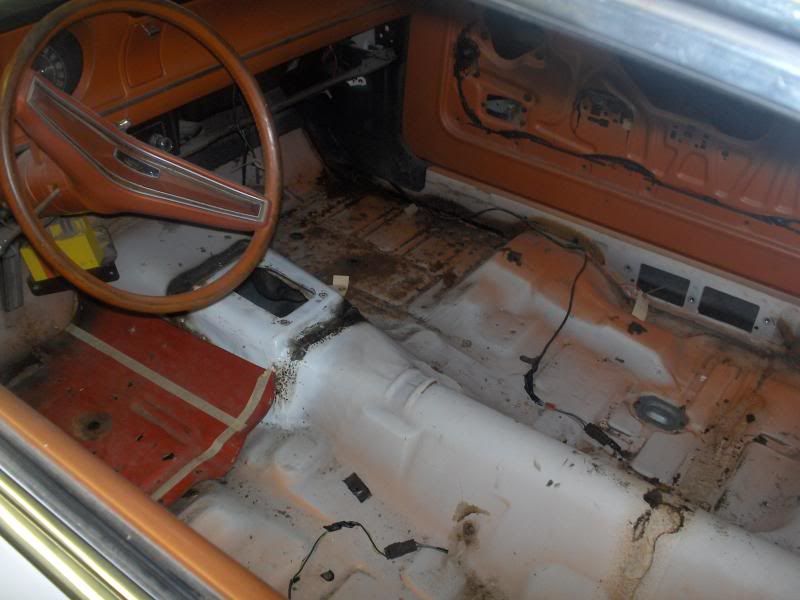

  4. Dave B
    Here's a picture of the floor in my 74 Grabber, bench seat car. It is closer to the front, than my 73's.

    Thanks for all of the responses! Great pictures. So, it appears the inboard mounting location was changed from 73 to 74. I have an original bench seat car into which I'm installing buckets. I found the dimples to drill on the inboard floor pan. But, obviously, there was no reinforcing type bracket on the inboard floor pan.
