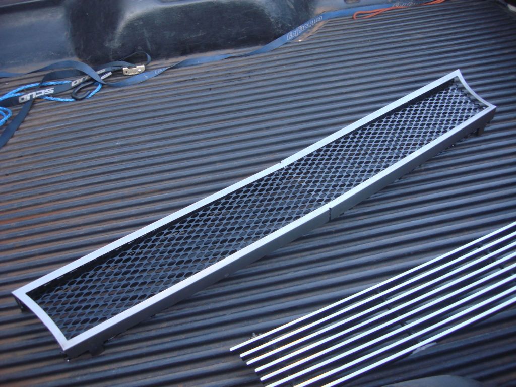

  10. facelessnumber
    facelessnumber Drew Pittman
    Oct 4, 2007
    3,710
    Memphis, TN
    '71 Grabber
    Amazing work as always! Thanks for sharing your progress with us. I can't wait to see how that grille looks on the car!
  11. topolino
    topolino Member
    Sep 21, 2011
    487
    Brazil
    thanks man!! :thumbs2:
    in fact,this grill is made of aluminium and the frame is only to check is is Ok..because the frame is in steel..the actual frame will be in aluminium also
    lets see...
