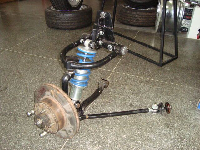

    Any more pics of the front suspension upper coil-over mount and its installation? Im curious about bracing as that area of the was not intended for that kind of side loading... or is it? The upper control arms mount there also but might not exert as much force as the coil-over does.
    Thanks. You are making this all look WAY too easy. Good work.

    Relax man! (y)
    GrabberGT this help?
    Cheers!!

    Thanks. It just looks so painfully simple. Know anyone using this setup already. Do they track their cars? What kind of front end bracing are they using to keep it all together? I might be doing something similar to this in the future and would like to know what kind of abuse it can take. I push my car pretty hard and wouldnt want something to fail.
    Thanks.

    As for the front setup, it looks fine to me..................I'm no expert, but have seen similar setups on early Mustangs. The shock tower was originally over designed and will take a tremendous amount of lateral force.......although some bracing probably woundn't hurt.................IMHO

    BTW..in front ,I am planning to use a custom montecarlo bar and a pair of camaro front braces (radiator to fender) and,of course tower braces (which by the way,will be one of the most beautiful parts of the engine bay.):bananaman
    next week I will post some pics
