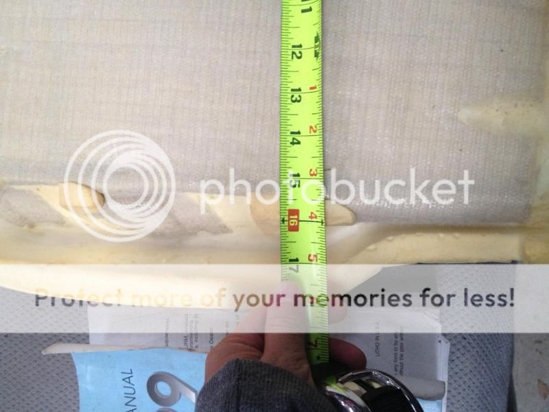

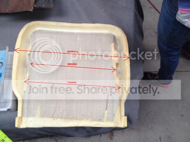

  8. mercgt73
    Micah,
    Here are the measurements I took for you. The measurements came from the new cushion for my Mustang '71-'73 seats.
    Overall width: ~21" -sides are really floppy, so this is kinda where they laid
    Width across the middle in the "recess": ~14 1/2"
    Width across the middle "frame to frame": ~16"
    Hope this helps.

    Rusty,
    Thanks for taking the time to get these measurements. What you have certainly looks like the underside of the Sport II cushion in post #9 but not like the ones that were on there originally.
