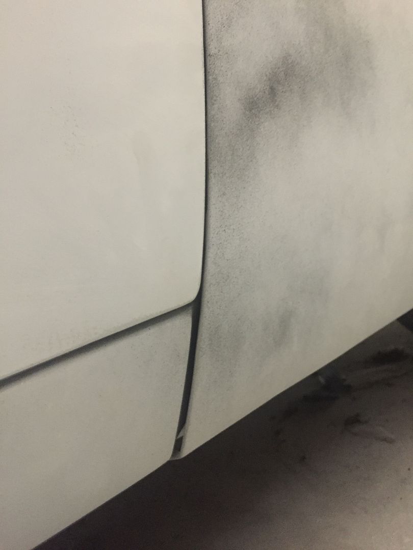

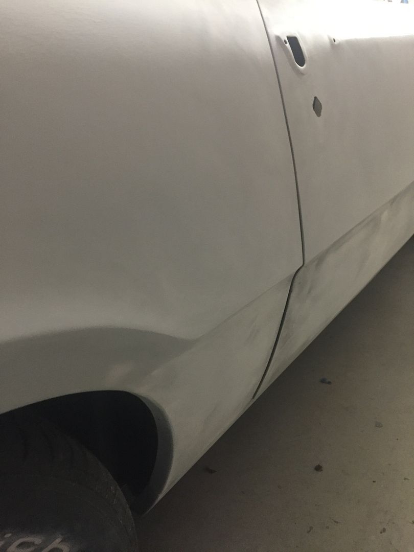

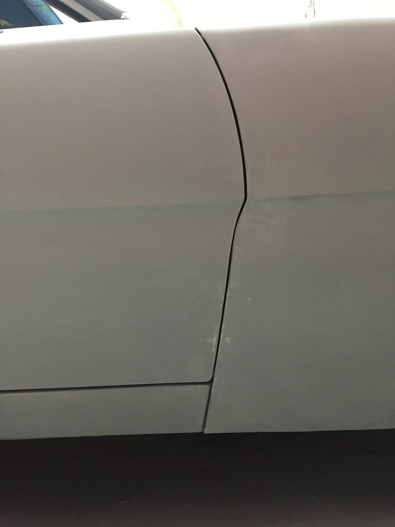

  4. Mavman72
    Pull the bottom of the door in at the lower hinge. You should be able to get it to move that 1/8th inch without upsetting the top. Then you can get the fender tighter to the rocker...If that doesnt work...Time to start thumpin and bumpin metal. Gotta say though, gaps are pretty tight, maybe a bit too tight but...Looks good. Is there weather stripping on that door still???
  5. 7D2 Grabber
    7D2 Grabber Member
    Apr 10, 2009
    999
    Northern CA, Bay Area
    No weatherstripping. Bottom doesn't move inward anymore. I'm thinking of elongating the holes on the bottom for the hinge to try and get the little bit I need.
  6. Mavman72
    You could do that or... Smack the door post (A Pillar) at the lower hinge and move the sheet metal in a bit.
  7. OLD GOOSE
    OLD GOOSE Member
    May 10, 2011
    656
    59
    101
    WV
    1972 ford maverick
    you could take a mig welder and weld down the side and fill and grind (a old school trick )or take some fiberglass filler smear it down the seam wait till it almost sets up then take a knife and run down the seam and sand off the excess( another old trick) use a hammer and a block of wood wrapped in a rag to pound it in or use a die grinder and widen the holes for more adjustment it is a Maverick it looks tight compared to Factory for show car gaps sometimes it takes all the tricks and shims and a little luck
  8. 71gold
    26,589
    2,935
    should install weatherstripping first...:yup:
  9. OLD GOOSE
    OLD GOOSE Member
    May 10, 2011
    656
    59
    101
    WV
    1972 ford maverick
    i agree weatherstripping makes a big difference
