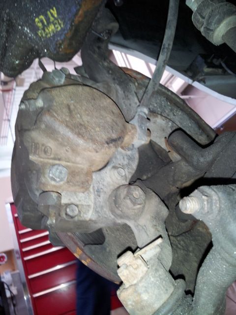

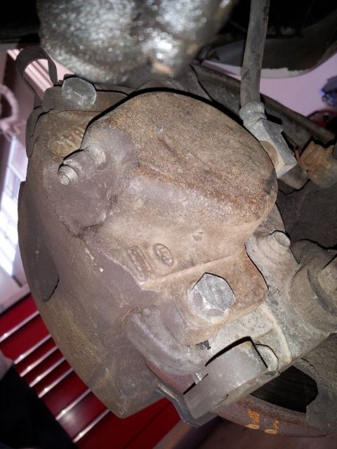

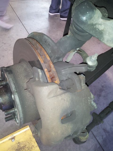

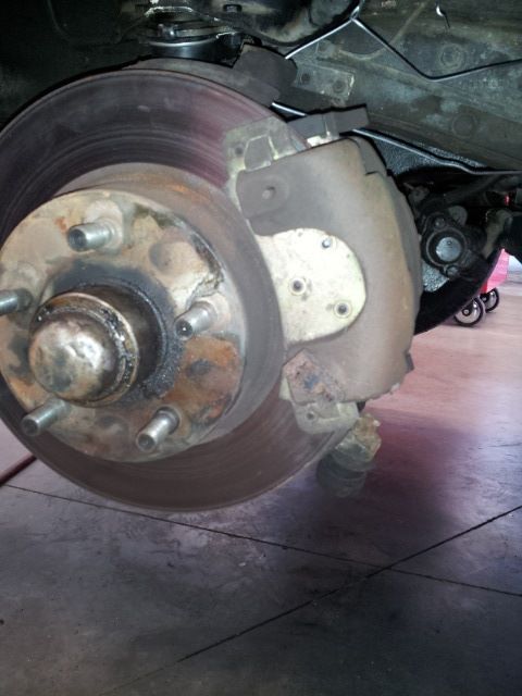

  12. vvr210
    vvr210 Member
    Mar 14, 2012
    586
    Vista,CA
    Im going.to have the tires off later on should i take pictures of the calipers?
  13. 71gold
    :yup:...that could be a help...:Handshake
    that and we like pictures...:thumbs2:
  14. vvr210
    vvr210 Member
    Mar 14, 2012
    586
    Vista,CA
  15. vvr210
    vvr210 Member
    Mar 14, 2012
    586
    Vista,CA
    Still trying to figure this out .Thanks
