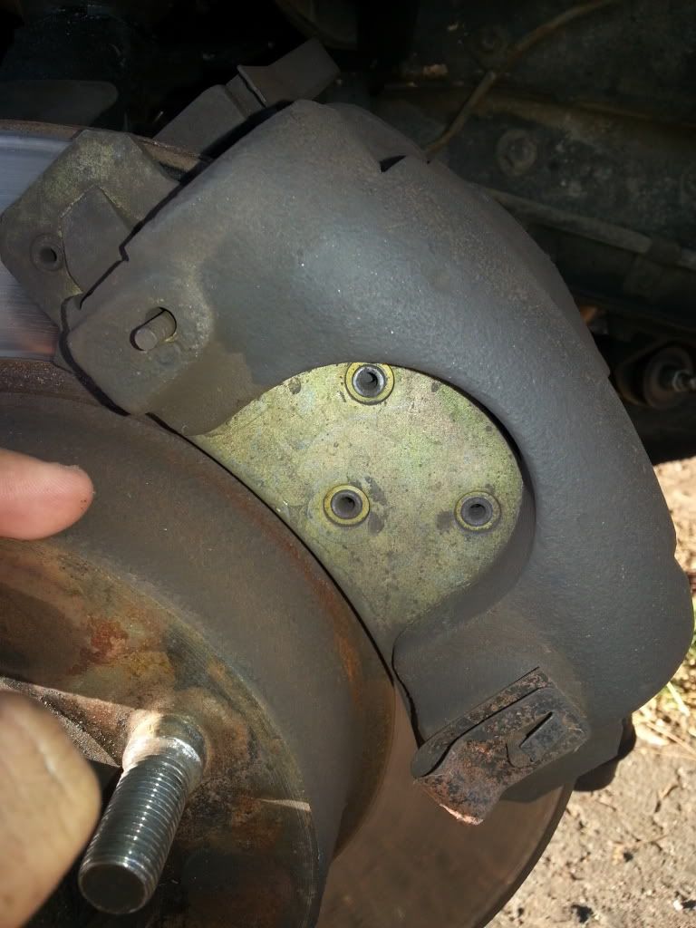

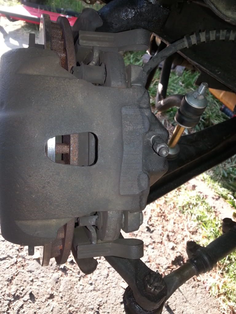

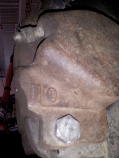

    Im still trying to figure this out.Is it safe to say that they're Torino or mustang calipers?
  2. Krazy Comet
    7,719
    2,433
    I'm looking at a empty caliper from my '69 428 Fairlane and I don't see any real difference...
    The size of the bearings changed from '69 to '70 so you need to know which they are for rotor/bearings, but I believe calipers & pads are all same...
    I don't remember my rotors having the extra slots between the lugs, I have a set from a '69 Torino GT I can look at tomorrow...

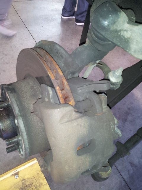

  3. 71gold
    26,589
    2,935

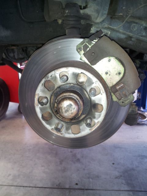

    I think those are...wheel spacers...:yup:
  4. Krazy Comet
    7,719
    2,433
    That crossed my mind but since it was staying in place so nicely, I wasn't sure...

    Yes they are spacers.

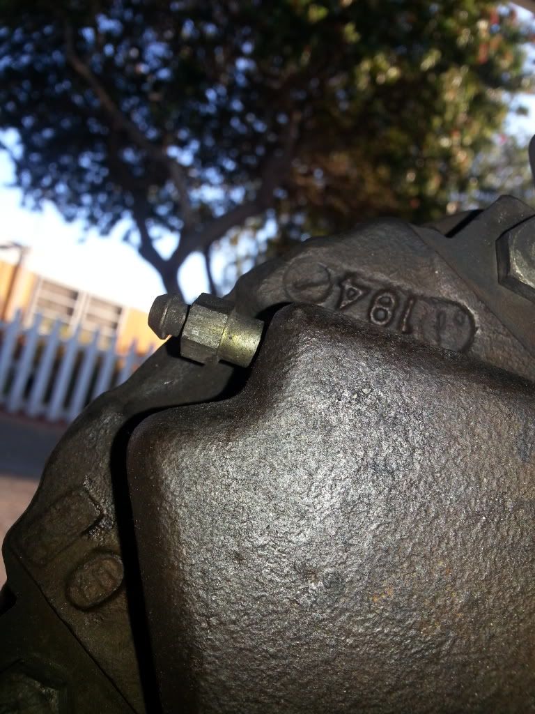

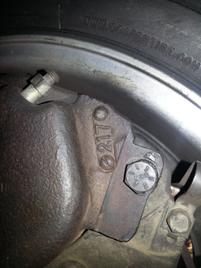

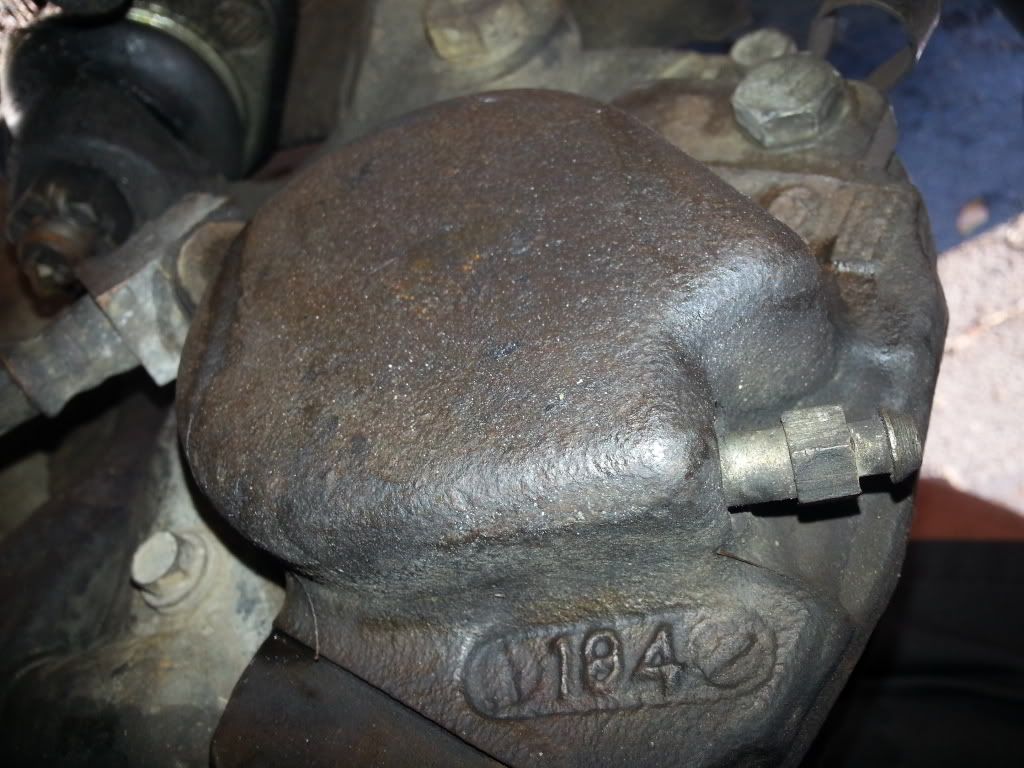

    I got a chance to look at the calipers today heres what I found.
    This is the drivers side caliper looks like a 184 to me

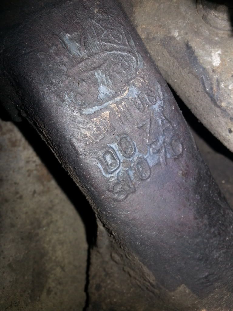

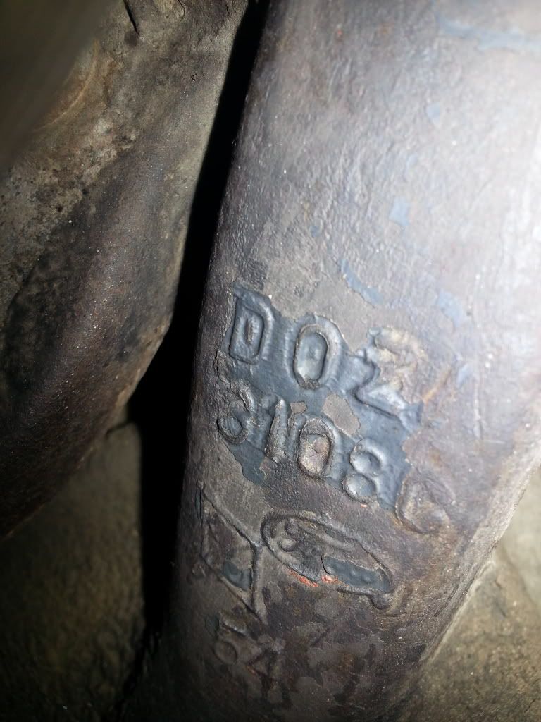

    Drivers side spindle

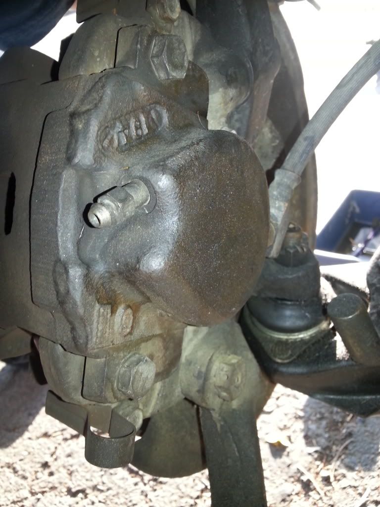

    Heres the passenger side caliper looks like a 217 to me
    and heres the passenger side spindle

    D0ZA on the spindle would indicate they are '70 Stang brakes, those use a larger rotor than the Granada(basically a better brake)...
    I'm gonna use same on my Comet but mine are from a '69 Torino GT...
    EDIT
    I checked the Ford Master Parts Catalog and found the '70 & '71 Torino/Cyclone used the exact same D0ZA-3107/8-C spindle... Note those are casting numbers and not the actual part number...

    So can I use 70/71 Torino/cyclone or Mustang rotors?
  11. Krazy Comet
    7,719
    2,433
    '70/'71 Torino & '70 Mustang use same rotors as well as the other brake parts...
