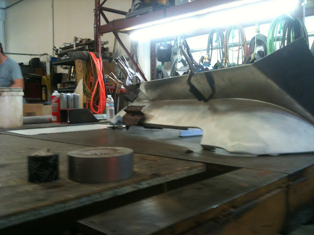

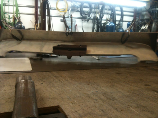

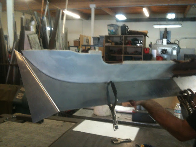

  9. Bryant
    heres the front air dam we are working on. it should be done tomorrow. we plan on reproducing this and the other aero parts that we are making for mo's car.

  11. groberts101
    groberts101 Member
    Apr 22, 2007
    4,166
    535
    297
    Minneapolis, MN
    that looks like a promising functional design. Definately wouldn't want to fall down in front of that thing! lol
    Are you going to use a splitter too?
    Just keep in mind when designing the mounting system that based on the frontal area of that sized dam and air entrapment zone under the front bumper.. there will be significant pressure and stress on all mounting points once you hit 130+ with that thing. Extra support in the middle and dont forget the very ends catch the most pressure as the air gets sheered, ripped and dragged off the corners(especially on sharply transitioned designs).
    Multiple angles or smooth radii are best as thet work like valve seats in the way they form the air coming off the dam and turn it more into a "splitter" to reduce wind resistance and still reduce the air buildup like a flat dam would. In my mind.. it looks cooler your way though. The most functional designs are not always the most attractive when you want to look mean on the street. lol

  13. mashori
    mashori Member
    Apr 21, 2006
    3,630
    San Diego, Ca
    1971 V8 Maverick
    Wait you guys know that's just a bug shield we designed right? :)

  15. mashori
    mashori Member
    Apr 21, 2006
    3,630
    San Diego, Ca
    1971 V8 Maverick
    Bryant's design! I love it.....came out great, looks very functional....
