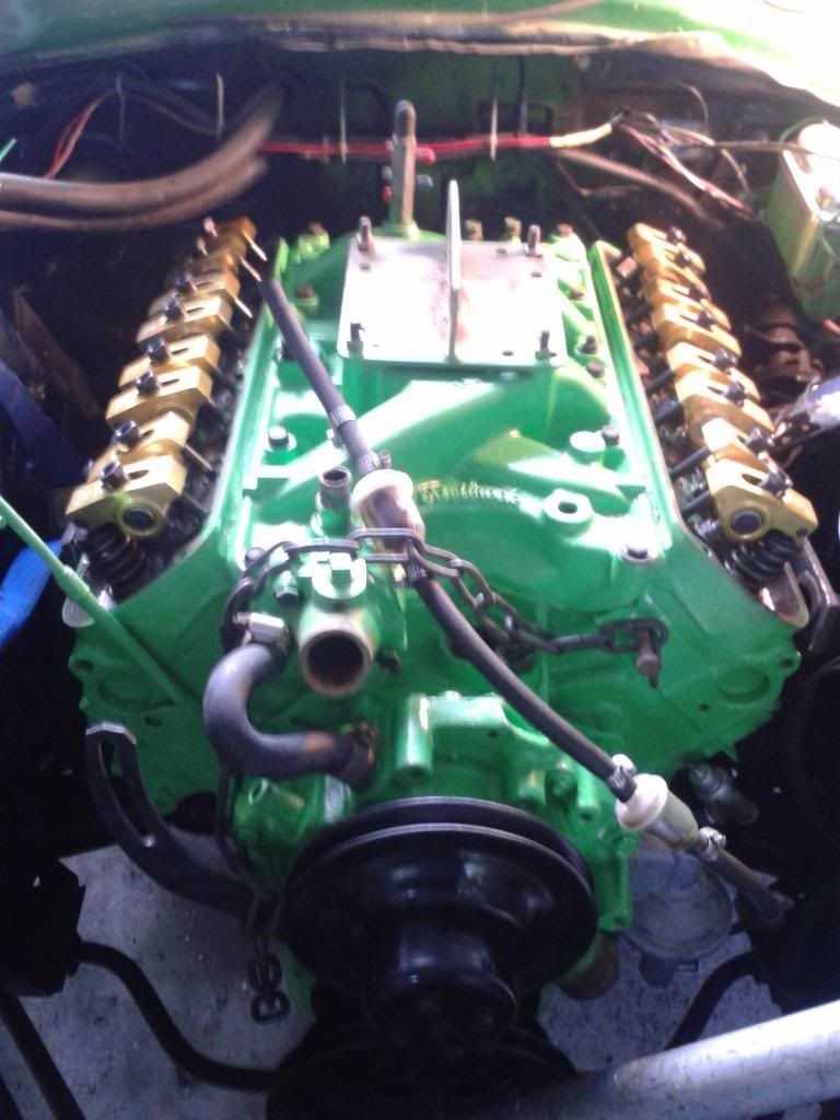

    In between the rain and sliding on the muddy floor of my shop, I did manage to do a little more on assembly...........
    Set up the geometry and set valve lash also, when it stops raining and I can wash out the shop, I am gonna pull the old engine and rob the parts I need so I can shoehorn this one in.

    Engine is in, not bolted in but sitting down on the motor mounts, really weird things going on today, I started this morning prepping the engine bay, got the engine up on the cherry picker and slid it over the engine bay, I then decided before I started to lower it to come in and take a good break so I left it hanging there, after about an hour I returned to the shop ready to drop it in and.....well it was already in there! no kidding, it had dropped right in place just barely missing the motor mounts, holy crap!! best I can figure is I didn't tighten up the valve on the crane enough and it slowly dropped in but geeeze, that was the first thing, second thing weird happening was I took a 2x4 and stuck it to the front of the engine for leverage and pushed, well don't ya know it went right down on the motor mounts AND straight onto the tranny in the right place, never happened before.....ever! I am feeling a bit like I am building a car like Christine! and to top it all off, and this is really strange, I only dropped my 5/8 wrench twice bolting up the trannys top bolts!
