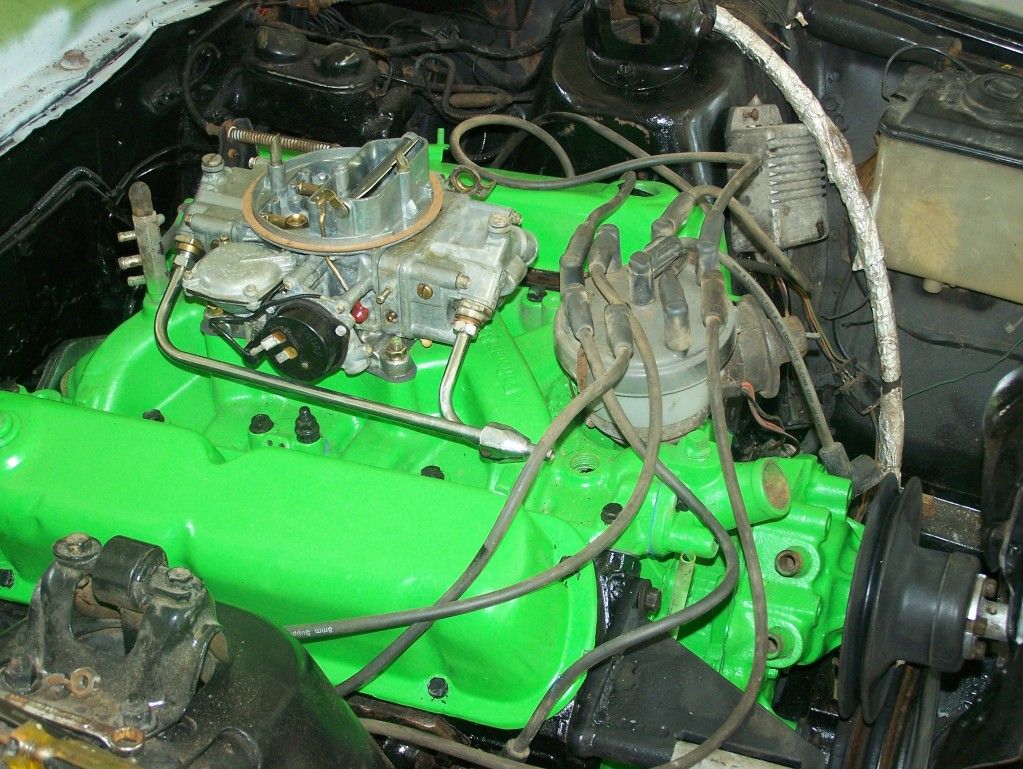

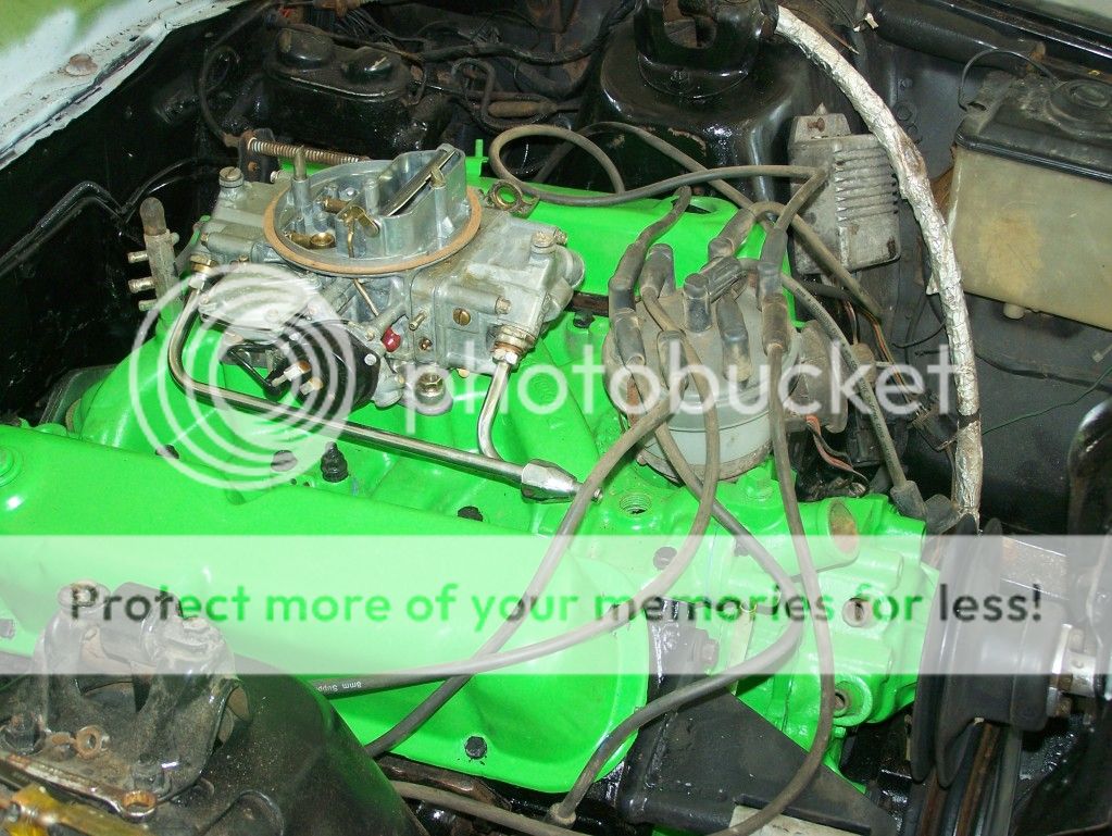

    Ok it is not completely installed nor are all parts cleaned yet, just trying to get it so I can start it up.......

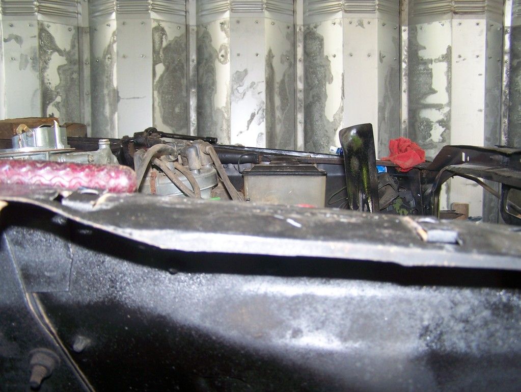

    And hood clearence is going to be an issue, mainly due to the fan, I will get an electric fan tomorrow........
    Still need to get radiator in but thats no biggie....I hope:hide:

    Got a larger better battery, installed it and tried to crank the engine, it will turn over slowly but there is no fire, got to looking at the wires for the duraspark ignition that are there, man these wires have been cut and spliced quite a few times and the connectors are pretty much trashed, I have another duraspark setup I am going to use tomorrow, just gotta wire it in PROPERLY!!
    Also picked up a Hayden electric fan yesterday, 16" gonna try it out.

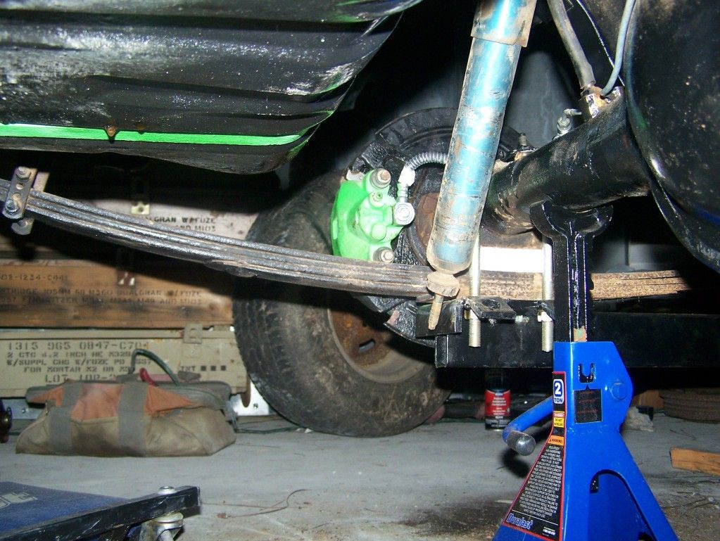

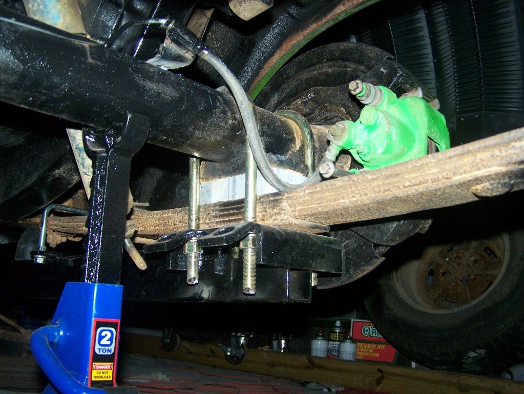

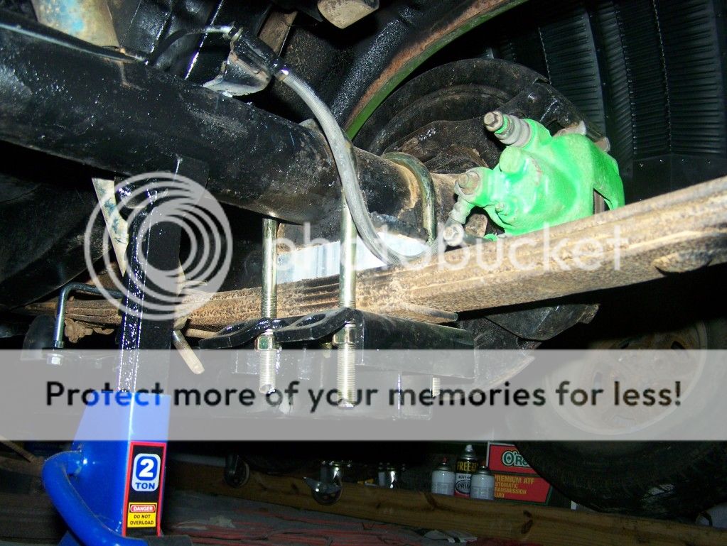

    Ok here is the rear disc install pics.....don't mind ALOT of what you see in the picture like those shocks, they will be replaced....and those mortar/shell boxes, well I don't talk much about those :16suspect
    It's all before finish painting and tweaking some of the lines but I'm almost there, my new master cylinder didn't come with a clip to lock the brake rod in so I have been on the hunt all day!

    That more is setting pretty high? What mounts and stands did you use?

    Stock stands and mounts, but I did use a spacer of sorts to raise the engine 1/2 inch for better fitment on the headers, also I was told a 351W is taller anyhow so I figured it wouldn't hurt to raise it a bit more and get a better fit, have to cut the hood anyhow so I figured might as well go UP ^^^, I don't mind cutting one of the three Grabber hoods I have ;).

    Sits about the same as my 351w..................although I have custom mounts for the engine and Powerglide trans.

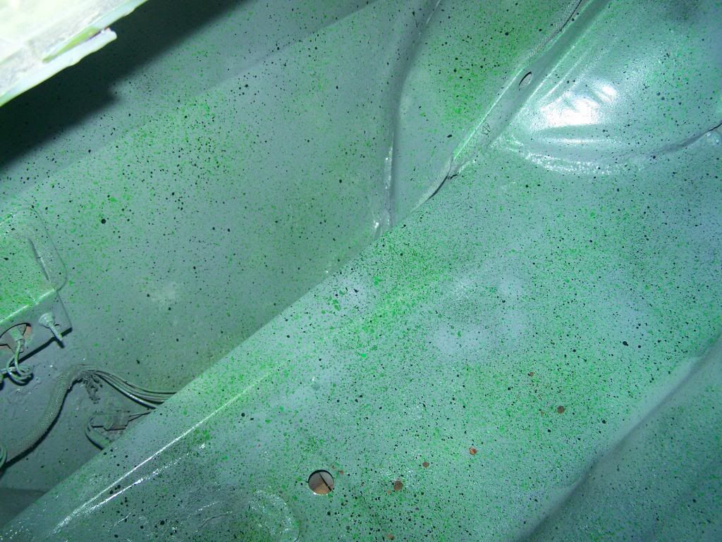

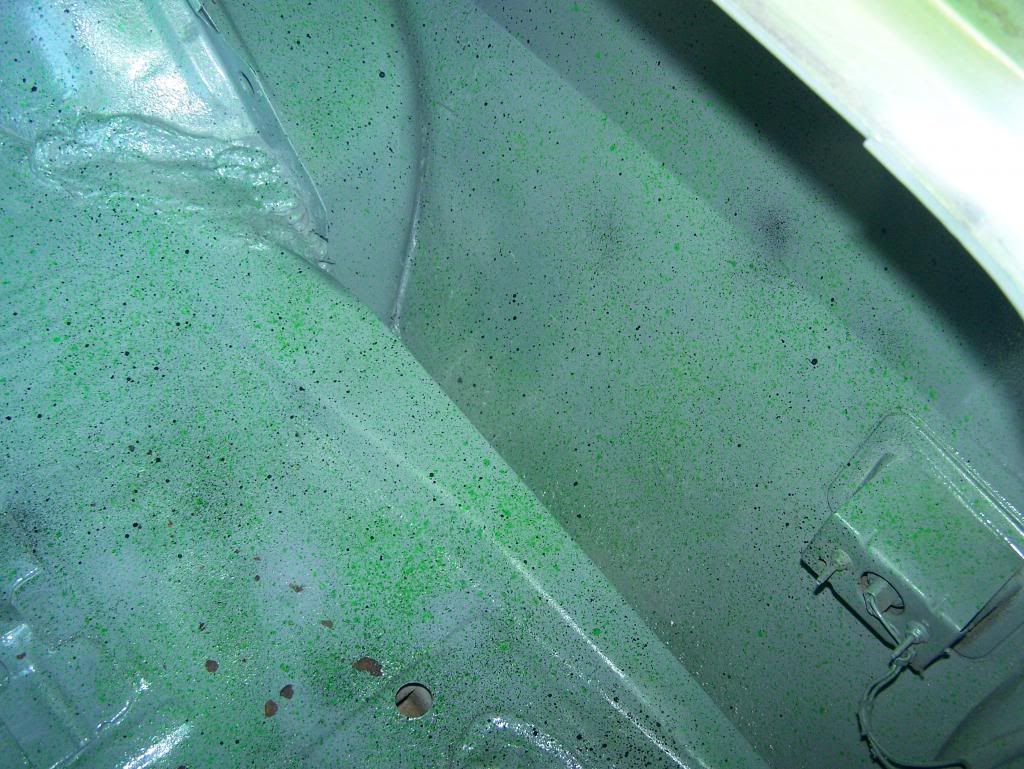

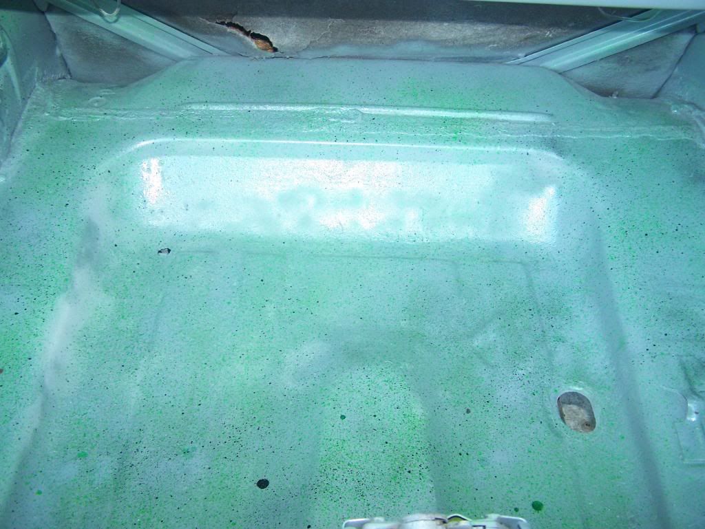

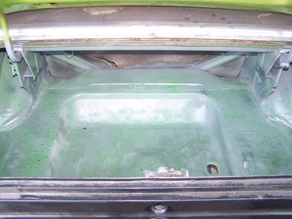

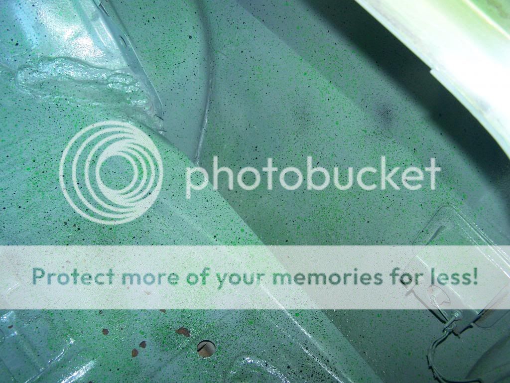

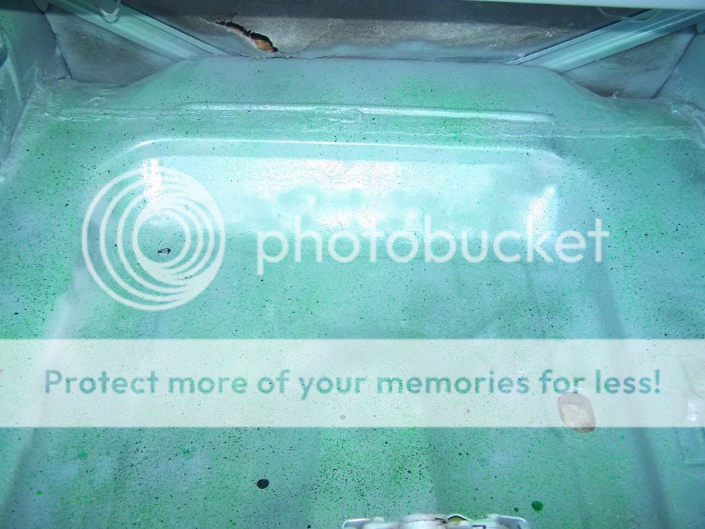

    Got tired of looking at that nasty trunk area.......
    So I stuck some paint on it! :D

    Aww come on Frank you don't like my splatter paint?

    I used GM trunk splatter paint on a green Maverick Grabber I had once. It was black/grey with specs of green in it. It looked pretty good.

    Yeah I painted it all gray, then took a straight pin and heated the end a bit and stuck it in the nozzle (WARNING do not try this at all) for the green can of paint (yes I removed it from the can first) and opened it up a bit, after that it splatters pretty good, moved the same nozzle to the black and did a little of it, anything would have been an improvement, it was really nasty looking.
    Also welded new metal into those small rusty spots I had.
    Prolly need to get a couple of potatoes and cut them for my eyes, might have burnt them a bit in that tight area of the trunk :yikes: if it gets too bad I do have some Procaine drops.
