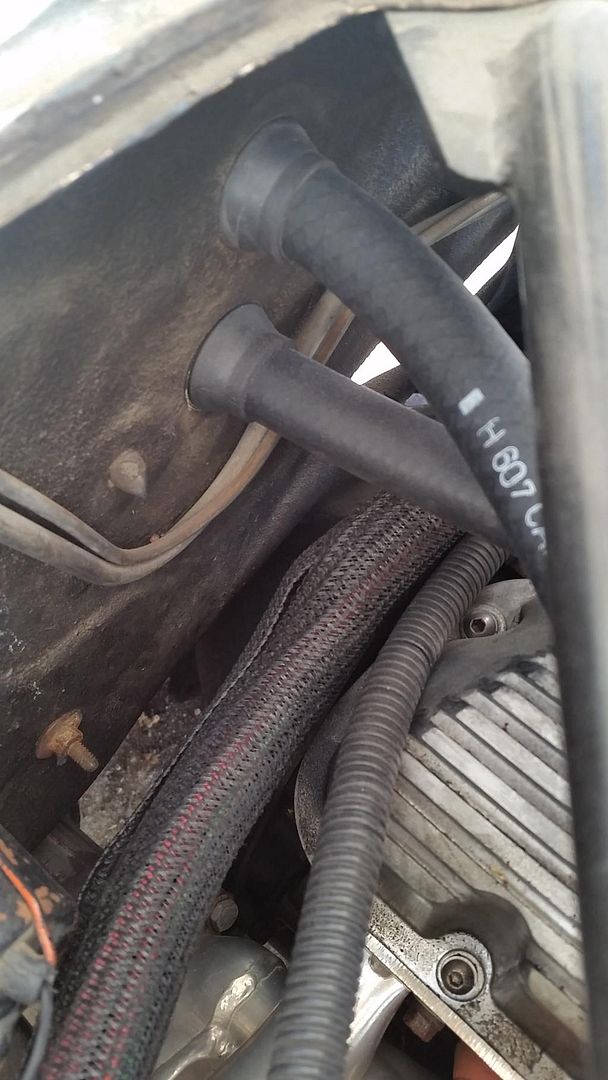

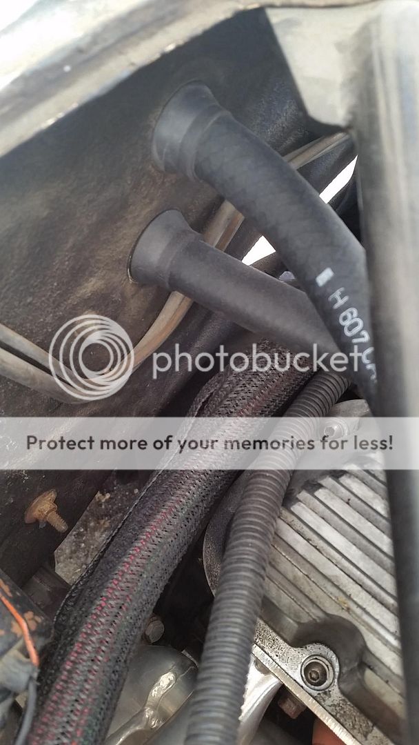

    I finally got the time to install my heater today. It was a nightmare trying to get it trough the firewall and I had my brother helping. I had the package tray removed but if the whole dash was removed it would've been an easier job for sure. I can only imagine how hard it is to do one with A/C.
    So I was wondering which hose goes where? I was thinking that the top heater core hose goes to the manifold and the bottom hose goes to the water pump. Is this correct? Do I have to drain the cooling system? And by the looks of it I might have to remove the alternator to be able to clamp down the water pump hose?
    And does anyone have pictures of how they routed the hoses? I remember seeing them tide down with a little clamp on the shock towers, but I cant seem to find the little clamp anymore. This is my first time replacing a heater core so all tips are appreciated thank you!

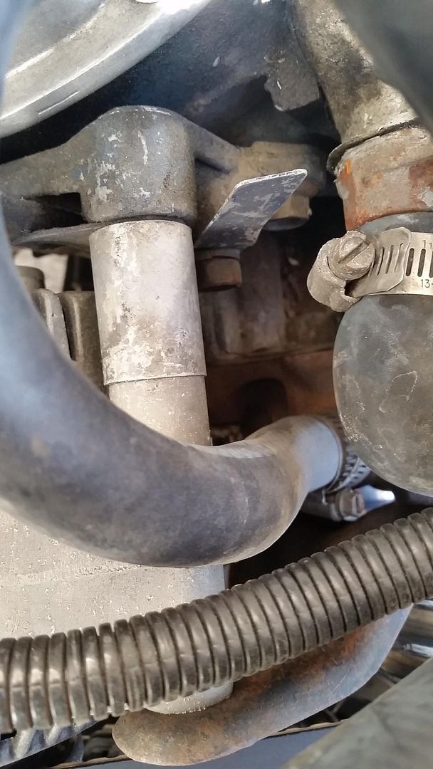

    Your hoses can go to either port if they are the same size, in the end they'll do the same thing, get hot water to the heater. Routing them is more about keeping them from rubbing on something. Here's a picture of the clamp on mine, it had a six originally and I'm not sure if they were different. 20150201_132906.jpg

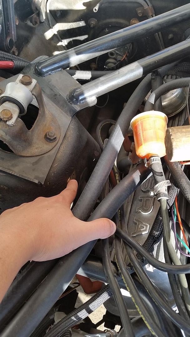

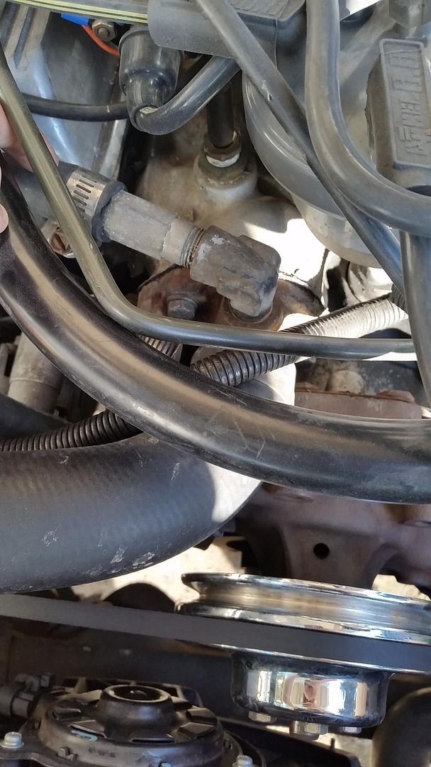

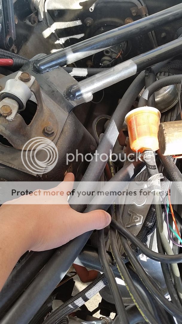

    Here is how I have mine routed. I don't have the top to the water pump as stated above by rthomas771, but easy to swap. I really don't think it will make much difference either way. I am by no means experienced, so this routing may have problems such as melting hoses. I think I might be able to insulate if this is not a good idea. Anyone have any experience with this routing?
    Anyway, it looks like you would need to turn the intake outlet about 30 degrees, so with old parts, that may not be an option.
    Good Luck!
