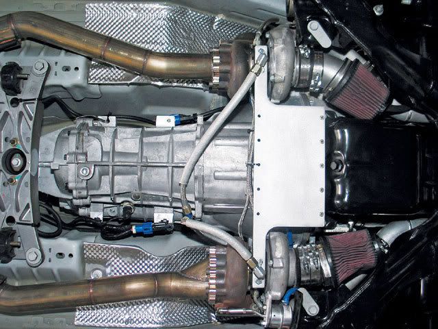

Kind of extreme examples don't you think? You don't really need a quarter of a million dollars to do this you know. How about this one? Does that look like an 820 hp street car to you? Capable of 9.60's at 142 mph? Air conditioning, power steering/brakes/seats/windows/locks/mirrors, six disc CD stereo with Kicker upgrades, starts and idles like a stocker, gets 20 mpg in town and 26 on the highway, takes the kids to school, brings home groceries, and kicks the crap out of damn near everything on the street. That's with rather small 54mm turbos and an air-air intercooler. Imagine what happens after I'm finished upgrading to a pair of 64mm PTE 6466 twins. 1200 hp will be a piece of cake.

It is a 305" three valve engine based on an FRPP big bore iron block, custom flat top pistons from CP, Manley billet rods (used these in anticipation of going over 1000 hp), steel stock stroke Cobra crankshaft, ported 3V heads with Manley stainless steel oversize intake valves and Inconel oversized exhaust valves, Comp Cams springs, custom ground camshafts (my design) from Bullet Race Cams, stock followers, C&L intake manifold, FRPP billet throttle body. I use ported stock exhaust manifolds too. Converter is a billet piece from Circle D Converters with a 5R55S transmission from Performance Automatic. It is their Super Comp model with their SFI legal bellhousing. I didn't scrimp on things but I also didn't use anything unnecessary. It's all about the combination.

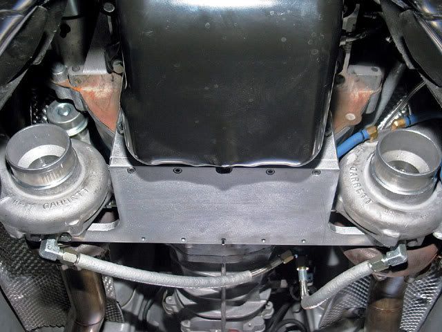

You'd be surprised. The turbos are mounted down on either side of the transmission. Pics show it much better....... I'd have to take a serious look but I think it can be done under a Maverick as well.
im pretty sure that there is not room for two turbos under the maverick. we cant even have long tubes not hang about 2" below the lowest point of the car. about the only way i can see putting two turbos towards the rear of the motor would be to have them behind the shock towers with the impeller side going into the fender well. this would be pretty simple on the passenger side but the drivers side would have to contend with the master cylinder and the steering box and linkage. the 05 and newer mustangs have tons of room in them. a local shop is building a 1500 hp 2012 5.0 that is going to be a freeway monster. the space he has to work with is incredible. the problem is here in california, this car and your car would never pass smog.
Show cars are for the rich and famous..............now what you have here is just about as perfect street/racer as you can get. Some suspension upgrades and that would be one serious road race car.........and a lot of fun to drive. Very nice engineering on mounting the turbo's. I have seen two late Mustangs with twin turbo's and they were both all the way at the rear of the car where the resonators/mufflers used to be. I could never understand why they did it that way...........and all of the plumbing.. and just didn't look good at all....................IMHJO
