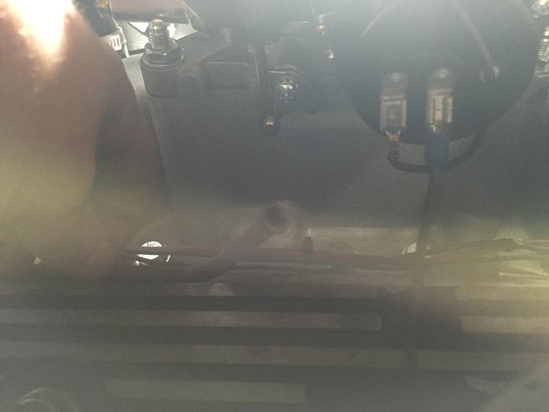

    The heater intake (?) port for the heater core..it's just aft of the thermostat housing and is a boss in the intake. The one on the Weiand is bigger than the one on my factory intake. Does anyone know the right part to properly connect the heater hose?

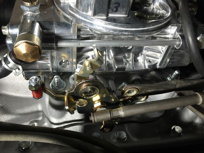

    The kickdown (from my C4) doesn't even get close to being able to hook up. I bought the carb with a JEGS kickdown kit but it has a bunch of stuff with no instructions and none of it looks like it can make the connection.

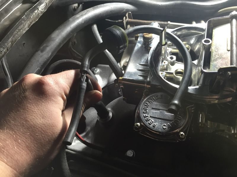

    There's a vacuum tube coming from down behind the block that goes into a T. One leg of the T was going into a small vacuum port on the Autolite and the other leg of the T, which is slightly larger in diameter, goes into a canister of some sort, then into another port on the Autolite. What are these and where on the Holley would they hook up? There's one vacuum port on the rear of the Holley that is way too big for these hoses and there's two vacuum ports on the front of the Holley...way out of the way. Any ideas?

    The water port I used a 90 with a hose barb on one side. Ill see if I can find the size I used.
    You need the kickdown kit for that carb. Its a bracket and a spring. Ill see if I have the part number.
    The canister that has vacuum lines is most likely the vapor canister from the fuel tank. I took mine off but I get a heavy fuel smell at times. I need to figure out where to run my vent to.

    You'll need a reducer for the heater outlet(sorry dunno size), may be same as 390/428, all are marketed by Mustang suppliers...
    The kick down will require the Holley extender linkage, plus you'll need to tweak the linkage for extra length... http://www.jegs.com/i/Holley/510/20...8&cadevice=c&gclid=CPOM9c6zucgCFQ8WHwodoTICTg
    Connect your PCV valve to connection under carb, if there isn't a vac port on rear of intake(my 8020 Weiand has one), then get some vac hose and plumb into the front port on carb that has constant vacuum... The tank vent mentioned was orig connected to the charcoal canister, do not plumb it to the manifold...

    I used HOLLEY-20-91 for the kickdown linkage.
    Used a 90 Degree, 5/8 in. Hose Barb to 1/2 in. Male NPT for the heater hose.

    As far as the vacuum hoses at the back, as far as I can tell, it comes from the transmission area as a metal tube then transitions to rubber. Then it splits into one plain tube and one with the canister. What would be the purpose of that? Can I get rid of the T and just hook up from the transmission to the port at the back of the carb?
    My intake has two large vacuum ports but I obviously am using one per side going to the valve covers...

    That 20-91 is a interesting kit, got any pict of install???
    Here's mine, as I mentioned the rod will need tweaking at bend nearest transmission hook up...
    This is the water outlet I'm using, got it from a friend who didn't use it, it's a Scott Drake repo(can't remember for what)...

    I show that I ordered the 20-91 kit as well but my lever reached. Here is what mine looks like. [​IMG]

    Turns out I already have the 20-91 kit. I just tried messing with it and I got the spring perch installed and all that but it looks like the lockdown adjustment screw will NEVER be useful...seems dumb of Holley for that. And that little 1" sheet metal extension for the kick down rod? Do they really think that's long enough? I have to hunt down a bolt to connect that anyway as they don't include enough bolts and I doubt that will be long enough as is...

    I would get rid of the tee, run the transmission line directly into the manifold port.
