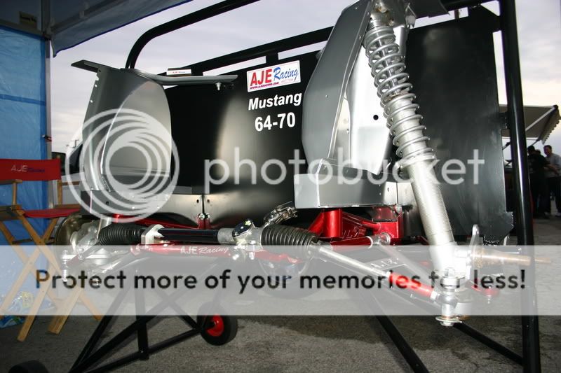

  13. okibono
    okibono Member
    May 4, 2005
    571
    cali
    Yeah, like Comet GT said, that kit is very nice. Another option that allows you to do a similar notch, and lose the lower control arm mount as well is the AJE kit.

  14. scooper77515
    If I did what they have in okibono's picture, I would take out even more of the towers. Doesn't seem like you need very much of those points sticking out at the top. Seems like you could just about go flat on the towers, then reinforce with a monte bar.
  15. CometGT1974
    CometGT1974 Gearhead
    1,583
    Western NC
    74 Comet GT
    I was gonna go with the AJE front end.....but, it modifies where the lower control arm mounts and the way it mounts.....not allowed in most "street car" classes.....
    Now, if I ever decide to go Outlaw 10.5 racing, that will be the front end that I go with.....
