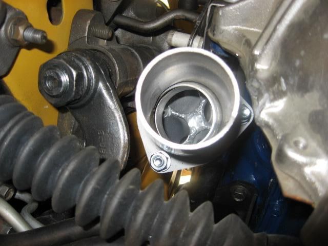

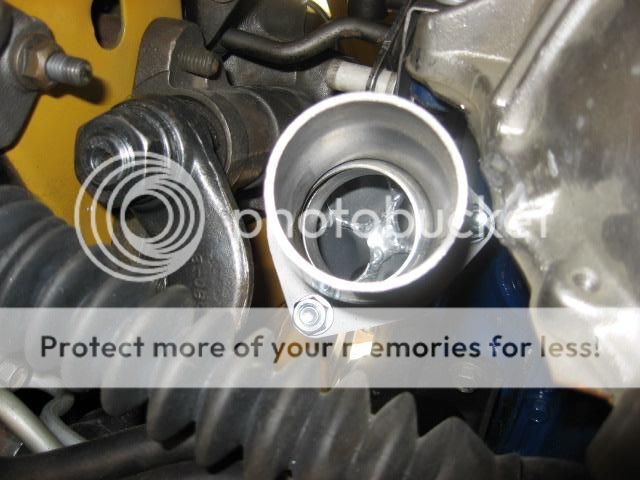

    is your steering turned all the way to the left? how much clearance do you have with the pitman arm to the pipe?

    OUCH!.. I don't see dead people or anything weird like that.. but I can see about 4 lost horsepower right there. Of course you're already running shorties which is the main problem.. but that just adds insult to injury, right there. :p
    Is it possible to cut into/notch that ball flange.. or the donut.. whichever it is that sits out in the flow column without compromising the seal?

    Arm is at center and yeah it will probably hit but I can at least steer the car now... There will be a custom pipe bent for it when I have the exhaust system installed...
    The exhaust system and a front end alignment will be the only two items I'm gonna farm out...

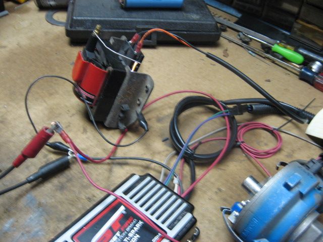

    This afternoon I checked out the Street Fire system I bought from Marcus last month, makes far more spark then even a Ford TFI system(yeah I lit one of those off just for comparison)... Will install it tomorrow...

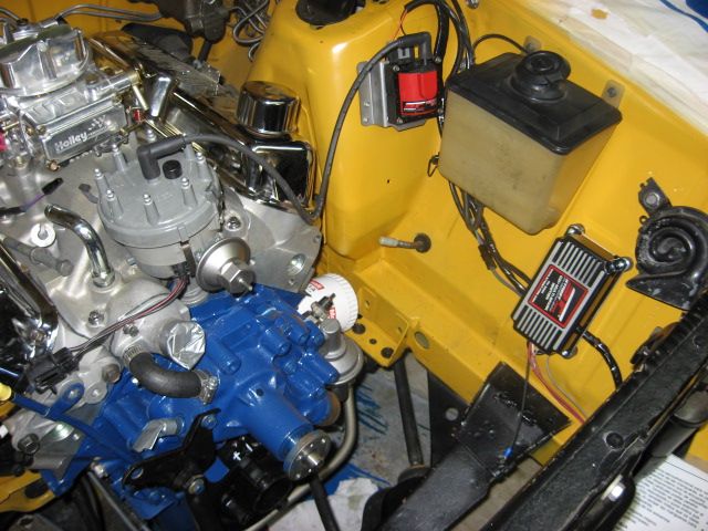

    Not had a much time as I thought I'd but finally have the ign system laid out, still have to tidy up the wiring mess... Original plan was to install it by battery but with the aux Painless Wiring fuse panel I'm adding, there wasn't going to be enough room...
    Yeah I'm gonna scrub the W/S reservoir and detail the horn, hung them in place to determine best fit for ignition...

    I have the same ignition system planned for my Comet. I like the placement, nice job!

    Thanks, I'd thought of mounting it behind the RH shock tower but decided heat could be a factor... Almost mounted it directly below horn but I figured a sudden blast may scare it(not really, almost blocks the horn opening)... There isn't enough space for mounting between reservoir and horn and I was afraid it may get wet if I mounted it horizontally under under reservoir...
    Without the auxiliary fuse panel I could have gotten it in by the battery but still that necessitates some creative mounting, with all the irregularities a custom plate is just about needed... It would be possible to slightly angle it and use two insulators on lower corner to level it out...
