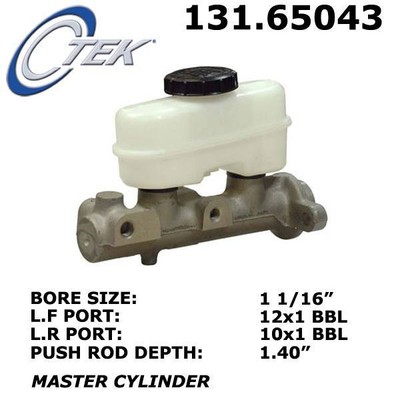

    The attraction I read out of junrai's post is that the Ranger MC fit the car without brake line mods. Junrai stated, ".......... I didnt have to change anything else. the lines fit right it no adapters nada bolt in bleed and go."
    That is why I asked the question, " did the 97 Ranger have 4 wheel disk brakes?"
  2. Krazy Comet
    7,773
    2,466
    I can't see how it fits as the port threads are metric...
    Port location is correct...

    I used ALL of my original brake lines. The two that go into the master are the same original lines, but I did grind the flares off the master end, switched the fittings to match the new master, and then re-flared. I only lost about an 1/8" of total line.

    also get the hard line fitting off the donor car (it's metric).

    a lot of people use the...ranger M/C. I ran the drum/drum before going rack n pinion, then went to a Strange M/C
