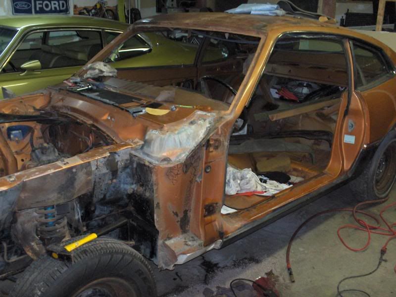

  10. Dave B
    I'm not really one for the filled cowl look, and I looked at his site, but I'd like to do a more permanent fix, Like Dennis did. So yesterday, I started drilling. It's not as bad as everyone makes it out to be. I only spent maybe 2 hours on and off during the day, and should have it completely done today.

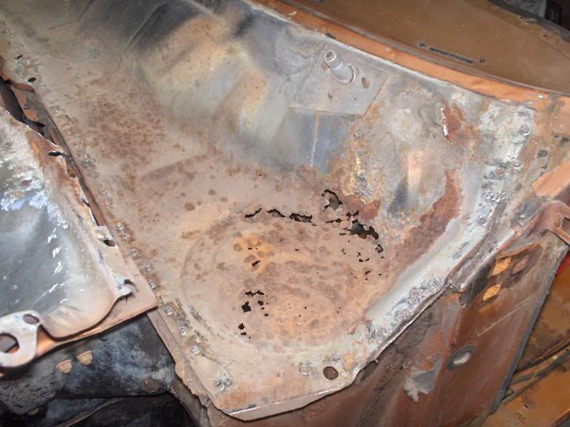

    it's definitely not that bad, i went through all this myself. please share some pictures when you have it all opened up!

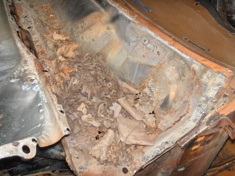

  12. Dave B
    37 years of leaves, pine needles, and whatever else made it's way in there....
    It's no real wonder they rust so bad, it looks like they used some sorta seam sealer right over the bare metal....This is a Arkansas car...
    I knew it had some rust when I bought it, but it was too good of a deal to pass up.

    ouch, this doesn't look to good. are there pinholes even in the middle section? hope you'll find a decent donor car!
