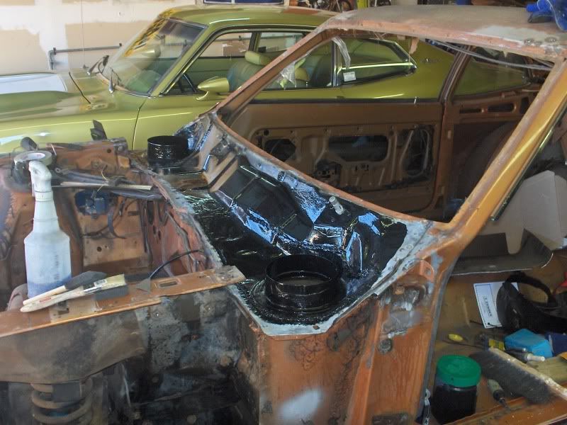

    I finished welding up the cowl today!! :bananaman
    I didn't bother grinding down all the welds no one will ever see (the law of diminishing returns), but she's water tight! Everything got a good coating of POR15 (the bare spots got weld-thru primer), and seam sealer on the inside, now just to weld the cover back on, and start on the floors. This car might make the Roundup after all.......

    I think it was more of a poor design, than anything. Right around the back of the hats, even the paint pools up. They used seam sealer, and a lot of it. From what I've been told, St.Thomas cars were dipped in e-coat, so you'd think that would have helped, I don't know about Kansas car (this is one of those)
    Either way, I gave it a second coat of POR 15 last night :)

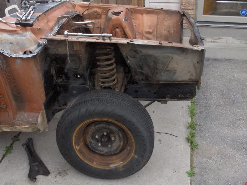

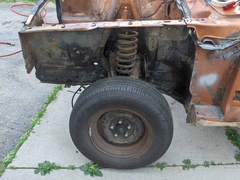

    Pretty much removed everything off the front end, except the suspension...Need to finish up a few welds on the cowl cover, then I can send it out for blasting. :D
