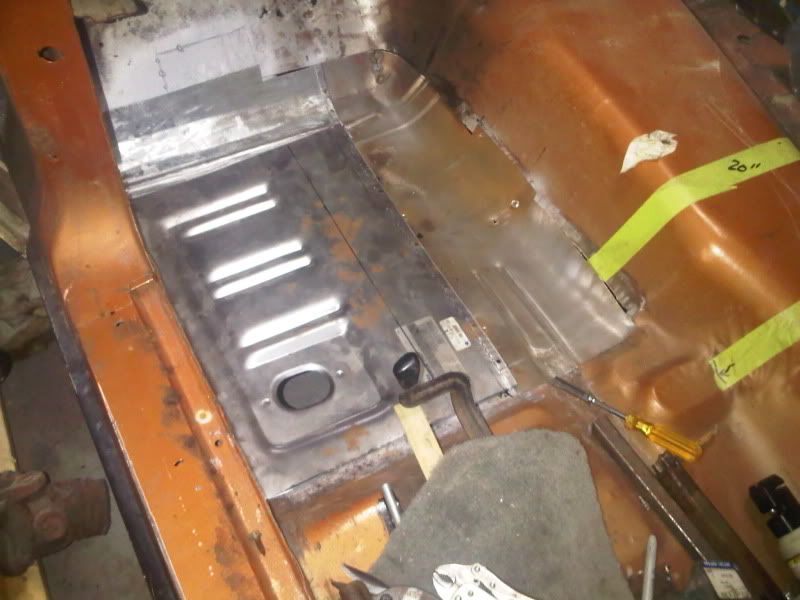

    Well, it's been awhile, but it's been way to hot to even spend 1/2 a hour in the garage. For some reason I felt the urge to do a little tweaking on one of the pieces I made to replace the floor pan, it's not done yet, but it's close. Maybe I can get this side welded up this weekend...

    Great looking fit Dave!
    I feel the same way...it's been awhile for me...and I'm still waiting on my seat covers to come back...don't want to update my thread until so....
    ...And I can't wait for the fall months to be able to do more...with the heat gone!
    Is this going to end up being White with Orange Grabber stripes?

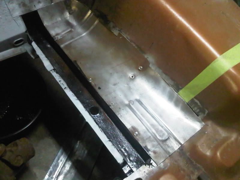

    Here's the other piece, cut and fit. Since the Mustang pans have the ribs in different places, and they are a wider car than a Maverick, I centered it up, re-bent the side lip, and fit it to closer match what was factory. If I can get home in good time tomorrow, I may tack it in.
    I'm not 100% happy, so a little more trimming and tapping...and it should be fine.

    looks like a great start Dave :yup:

    Looks like a good fit......

    Lookin' good Dave.
    Wish I had done my passenger side this way ... would have been less work ... live and learn. :thumbs2:
