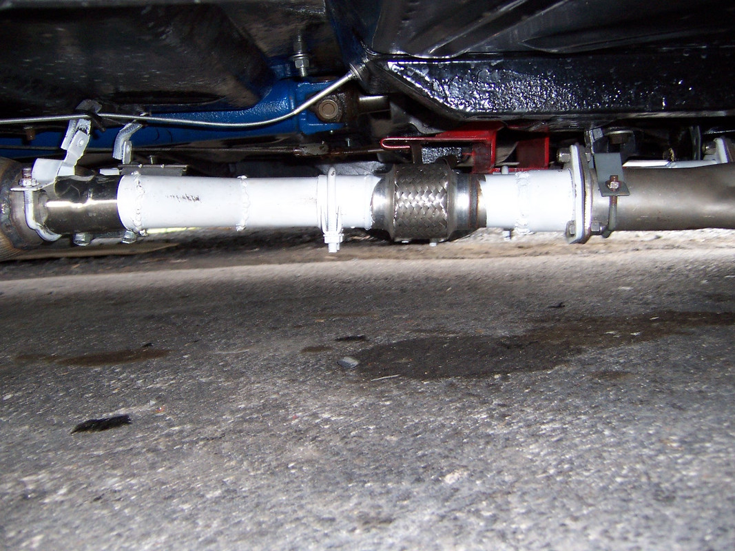

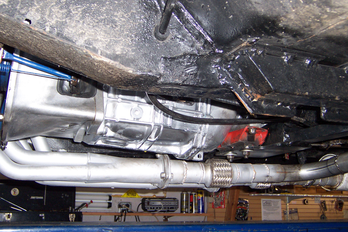

    The Dual Out longtubes' are subject to a lot of strain/torqueing' at exh.ports due to their length and weight. A good practice is to sufficiently support them AND provide Flex-Pipe fittings at collectors to keep them intact.
