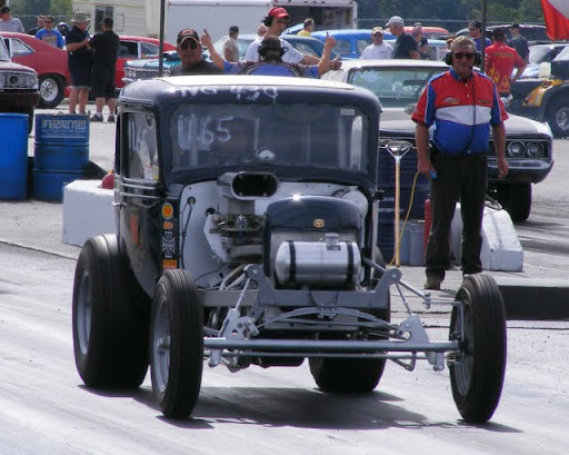

    Ok the pics he sent me are really small let see what we can do here.
    1936 Bantham running a stroked 250 6cyl ford.Best pass 11.58
