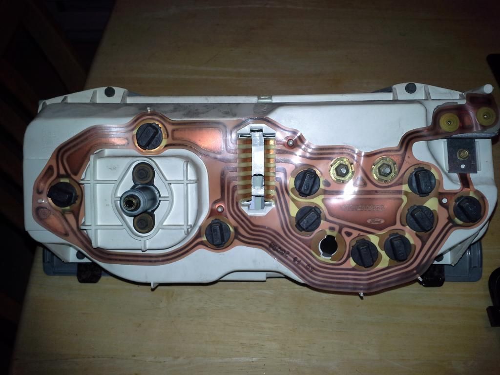

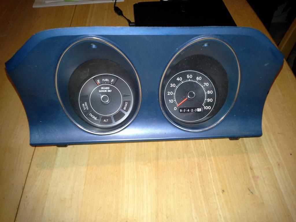

    Made it out tonight still does have lens guess I pulled lens off another. This is from a 76 Comet I parted out was running car all seemed to be working speedo gas gauge etc. $ 30 plus the ride pm. me if interested[​IMG] [​IMG]

    Yep, definitely interested. PM sent.
