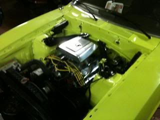

    Little bit of an update

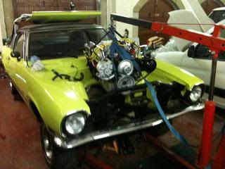

    Well its been a while after waiting for the engine rebuild kit to arrive from the states and finding the time to put it back together, which was nowhere near as easy as dismantling the engine! Plus I'm sure there were pixies stealing nuts and bolts, even after they were bagged and tagged and put in one box!
    Few pictures of the progress.

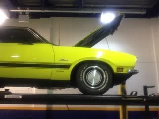

    Whilst we were waiting on a few bits and pieces we brought the front down so it wasn't so much Grandma going out for her groceries.
    Got the car through an MOT
    Car is now Road legal again in the UK and took it to its first outing of the year
    But noticed something wasn't sounding right and established it was not getting any compression in one cylinder. So went home on the back of the big yellow taxi.
    With alot of help from a friend, worked out that it was one of the valves in the head, which had been machine shop rebuilt for a fair sum of money. Took it apart and one of the valves was sticking open and should never have been put back in during the rebuild. Its broken the guide, scuffed the piston and now my engine is in bits again.
    Now need to see what the machine shop have to say. Hopefully there is no damage to the piston and they will replace the valve as they should have done.
    Its been a stressful but informative journey that doesn't look like its over yet!!! Not sure I would do it again in a hurry but definitely worth it.
