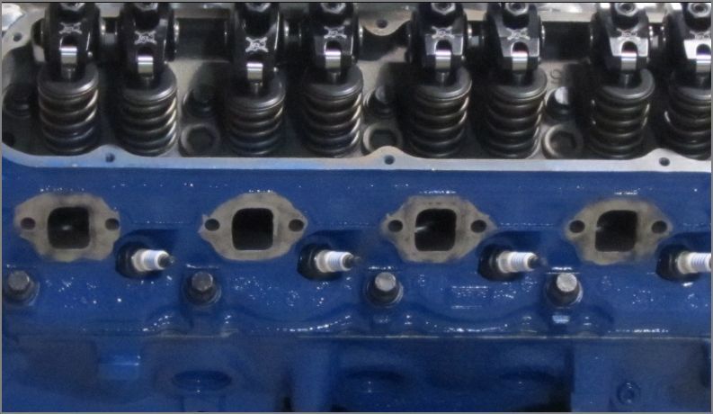

    Heres a pic of a set of heads that 1 and 3/4 tubes would work well with, ports are MASSIVE, it's all about the ebb n flow.

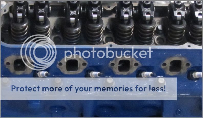

  10. olerodder
    olerodder Member
    Nov 22, 2009
    2,983
    NorCal
    These heads are off a 351w and actually use 1-3/4 stepped to 1-7/8 to produce over 640hp.
    It's not just about the heads, but the intake, carb, and cam..........................

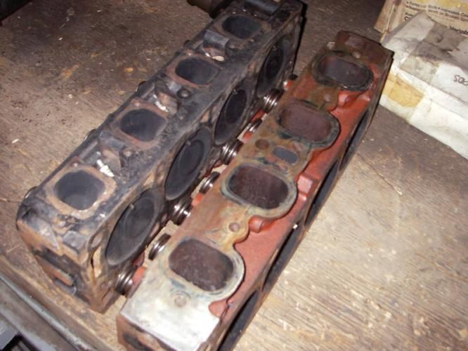

    Whats the cast # on the heads ? Heres a set of 69 351 W's that i am running, the exhaust ports look way different than your pics.

    Is that a pic of TF-R heads ?

    Yes, these are old Roush/Yates heads of 12/13 years ago.
    I'm not going to argue, but duration and overlap together with lift can make a huge difference not to mention intake flow and carb flow...................give me a PM if you would like to continue the discussion.
    The motor that was in the Maverick before the 408 was a Boss 302 and it had a set of 2" Tubular Automotive's headers..................back in 1979 it was turning mid to low 10's.
    For a street motor making less than 400hp 1-5/8 is big enough.................and with stock heads you could probably get by with 1-1/2"...............IMHO
