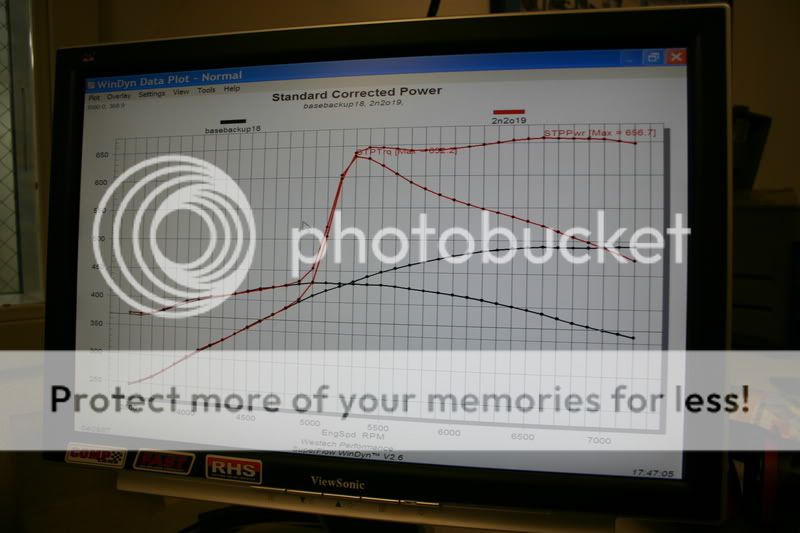

    Thanks! It's a stock block (early block) 347 with RHS out-of-the-box heads and an Isky flat tappet camshaft with about 250 degrees at .050. I was very happy with the numbers. Also, the engine repeated on motor after we made 656 with no problems. I will possibly have the new Boss 8.2 block soon because I know the block is bound to fail later down the road. I used the Valley Girdle PRO and a main girdle and i feel it should last a while, but we'll see...
    Oh, and it has a Nitrous Supply direct-port system.

    nice !!! Is that with the nitrous?

    494 on motor, 656 on a 75 shot (y)

    Killer man... thats pretty darn good! Has it been down the track before? The motor i mean.

    Nice car and nice numbers...(y)

    Wow great numbers!!! Killer looking car!!!!! Those RHS/Pro TopLine Heads are really gooooooood!!!!!! Just curious what headers did you use?

    Wow, thanks for all the compliments guys! The old motor (with different heads) made 551, and went 11.23 with a 1.8ish 60ft.
    And I am using Hedman headers and will have to "massage" the tubes to get spark plug clearance. Not looking forward to that one.
