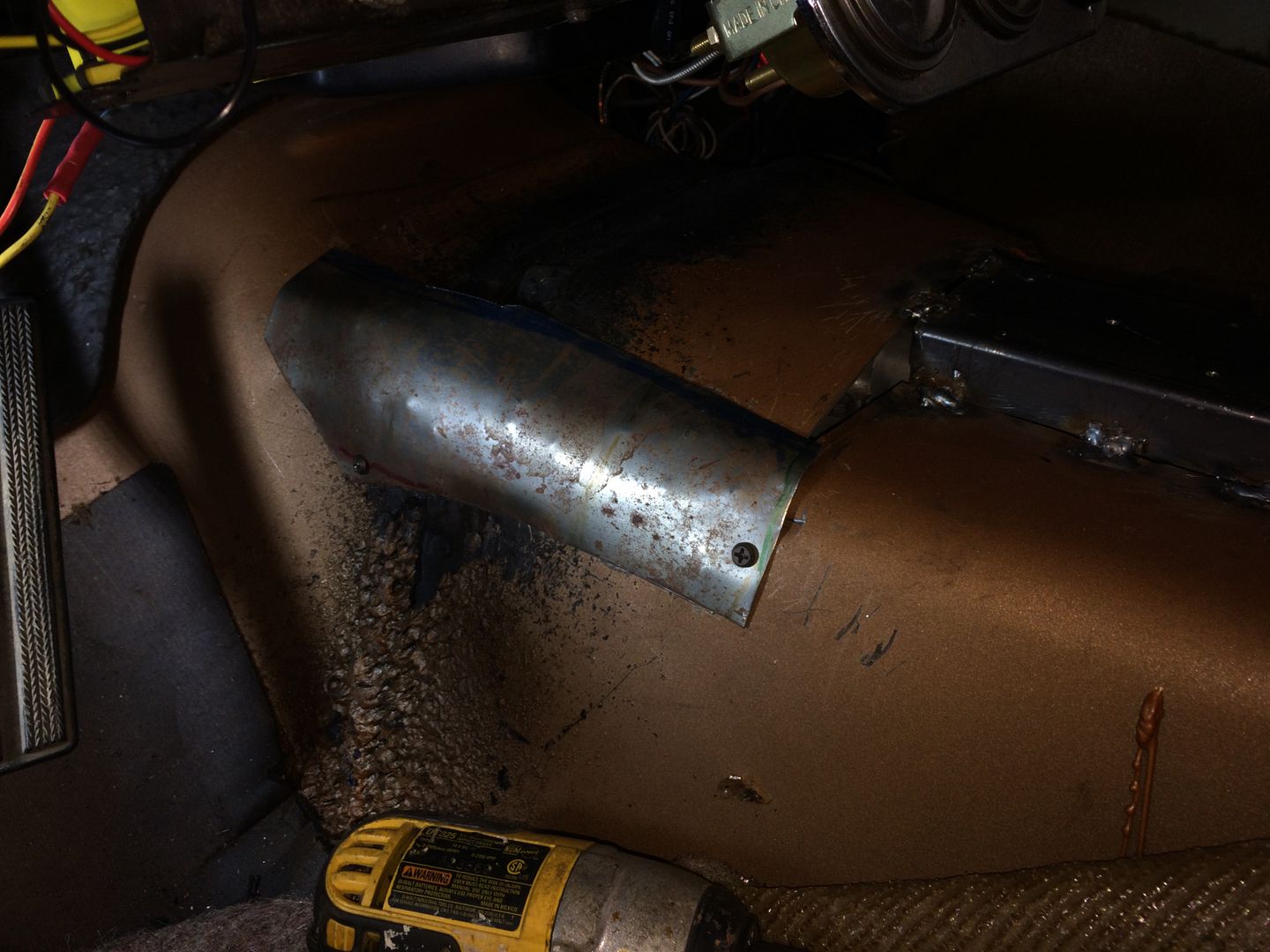

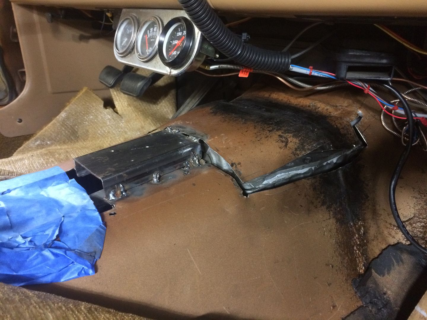

    Some have done T5 installs without tunnel mod, I swapped 3 OTT Toploader for T5-Z in my '74 .

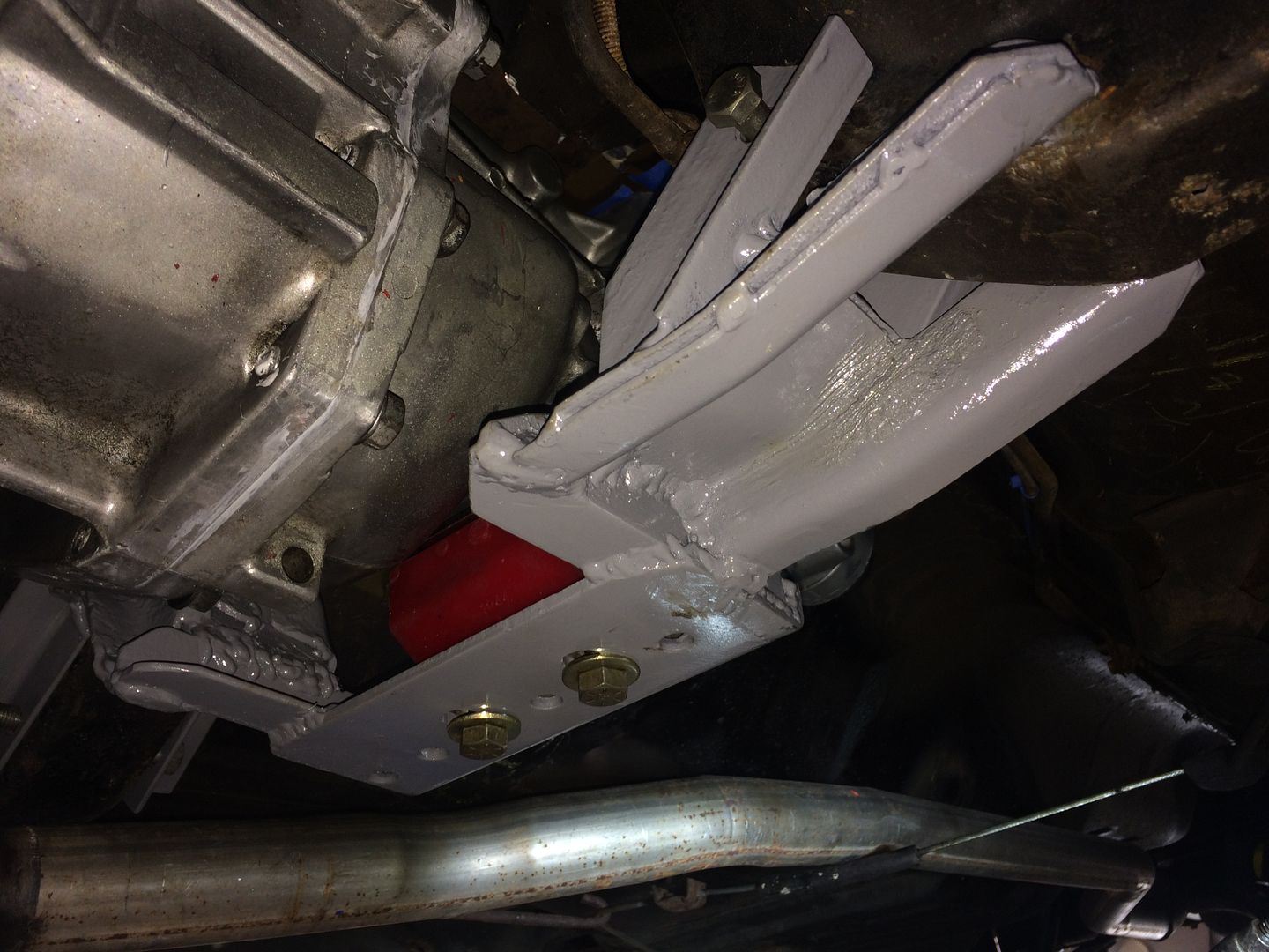

    I started by measuring distance of tranny output shaft below body and fabbing a T5 mount to match :
    Modified original Toploader 3 spd mount to fit T5

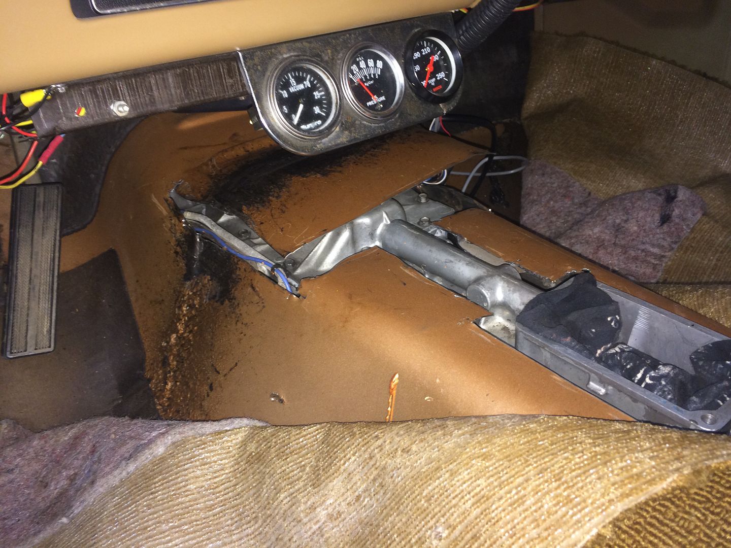

    Tunnel needed small amount of raising to put tranny center shaft at same level as Toploader

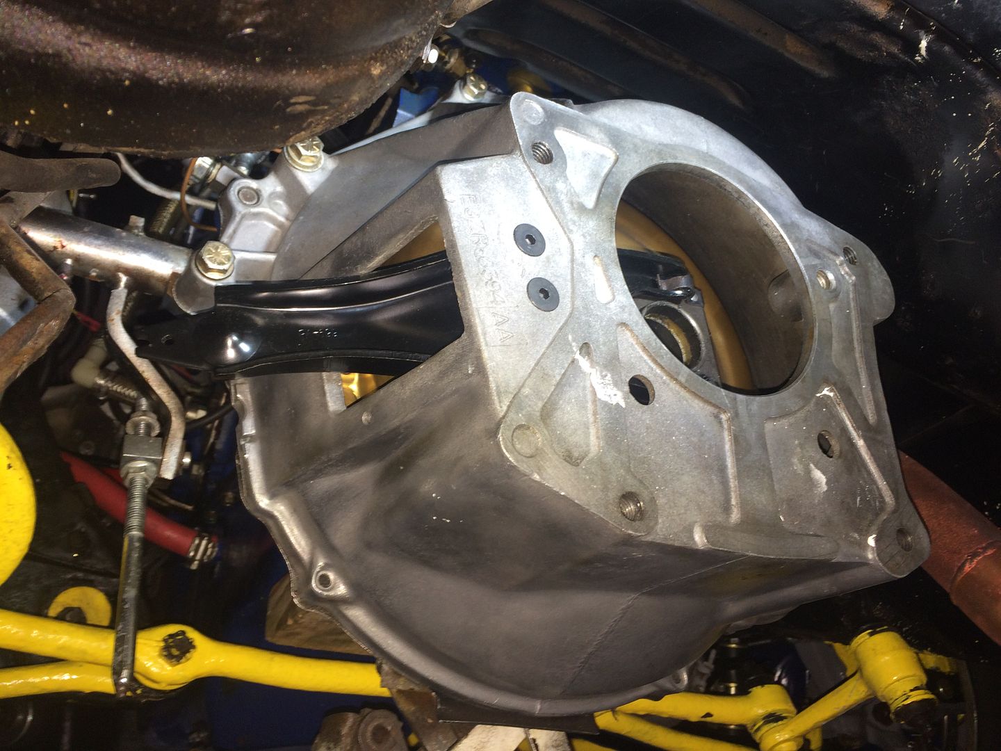

    T5 bellhouse with pushrod linkage fulcrum block mod;
    have fun

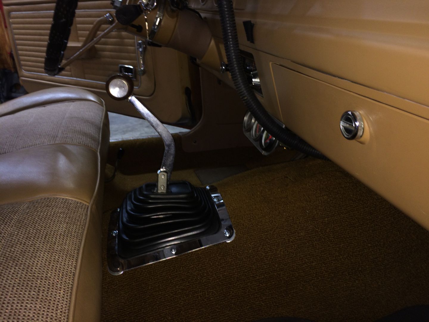

    Information like this is so much better to know BEFORE one starts buying stuff for a T-5 swap. The picture of the tunnel mod is a bit shocking at first, but the carpet makes it look like nothing ever happened. Nice job, and thanks for sharing.

    yikes mines not that bad, lol. I think im gonna just cut the tunnel, right now the driveshaft is rubbing the e-brake cable. it it needs to to go up another 2-3" to be correct. I only have room for maybe 1" without surgery, that would clear the the Ebrake but leave my headers a lil low still.
