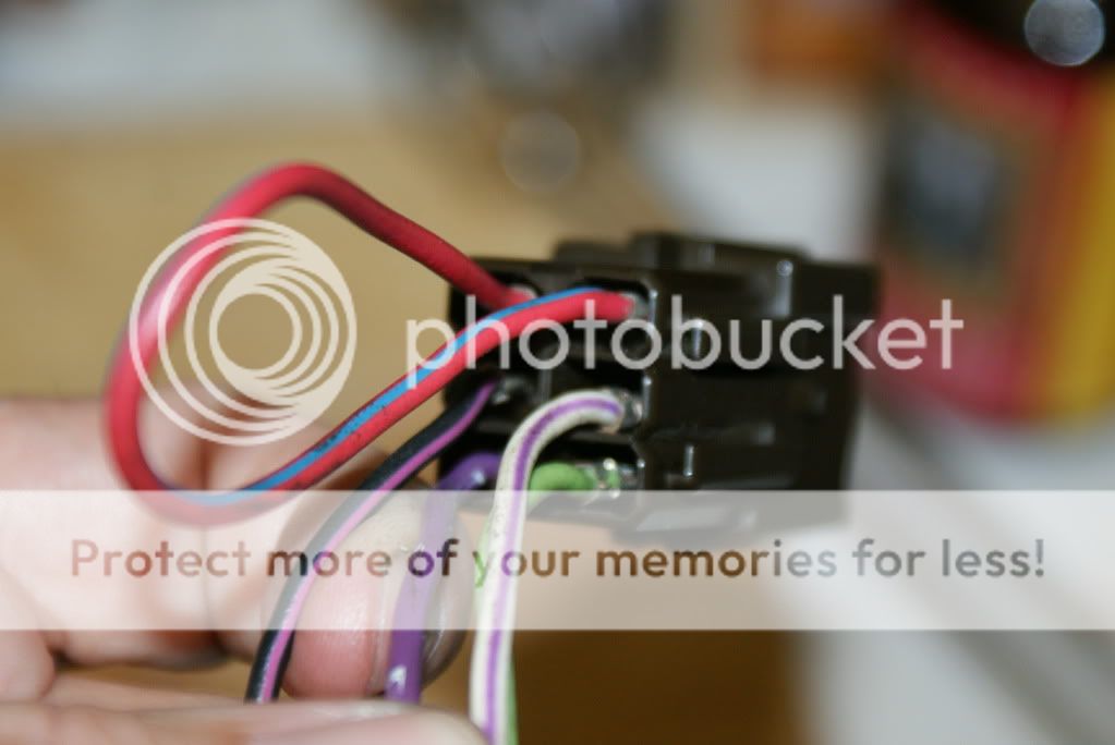

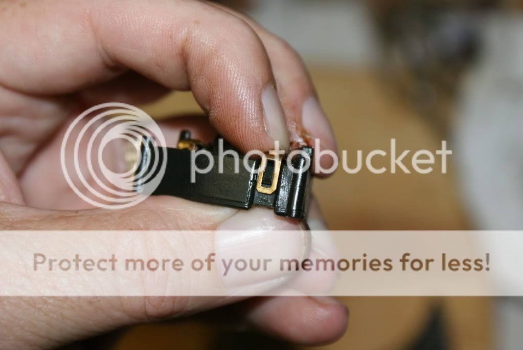

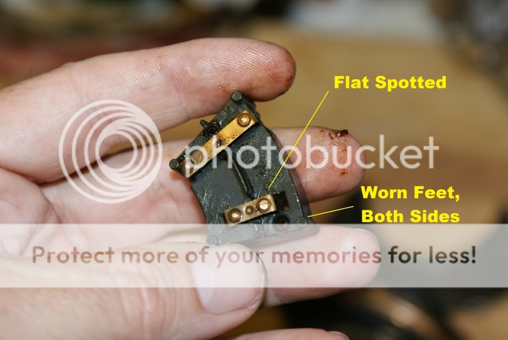

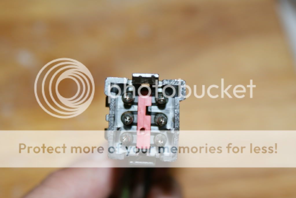

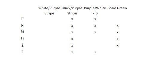

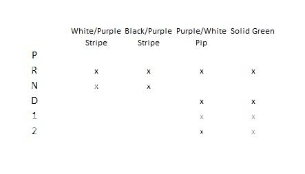

    Here's my finding on the original switch. I used a multi-meter and determined each connection for each switch position (P,R,N,D,2,1). The switch operated on a simple open or closed connection (breaker point).
    The below graph illustrates the way the switch is suppose to operate.
    x = connection
    blank or NULL = no connection
    Attached pictures show the connector, the inside and outside of the switch in detail. If you look closely at the short jumper (middle two radius connectors) you'll see one is worn pretty bad (flat spotted). The outside radial connection never makes contact, I believe this is due to worn feet on the sliding connector.
    My results on the original switch (not the used NOS switch).
    The above clearly shows the switch is bad, remarkably there is a connection in park! That should not be possible but I checked several times.
    Once the replacement NOS switch gets here I'll test that one. Then, I'll test the used NOS part sent (the one on the car now). I'll look at all three results and post the findings.

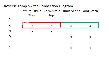

    I received the part a few days ago. I verified the connection diagram and made one change (See picture below). I verified the quick splice connector is not factory and believe the previous owner was attempting to defeat the seat belt safety buzzer and light. Since I pulled out the original switch I have not blown a fuse (I was blowing fuses regularly). I'm about 99% sure the quick connector was the cause. I pulled the used NOS part out and verified it was good. I had it installed incorrectly. The new switch came with a red peg in it, the idea is you put the car in drive, install the switch and pull the red peg out. Once completed the switch is in correct position. Unfortunately, it didn't corrected the original problem I was going after. Time for a little diagnostics.……… :hmmm: At least on the bright side I got a more important problem fixed. Success on the master brake cylinder, the brakes work much better! :dance: Well pretty good for all wheel drum brakes anyway. I think the oldest got a little tired of hearing me yell "pump" and "hold" LOL!! Back at it tomorrow! (y)
