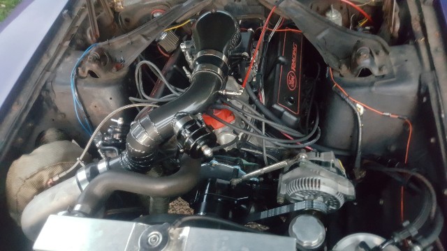

    I did my car with factory shock towers. Been turbo for over a year now. Runs awesome. I ended up grenading a shortblock due to rev limiter being set too high for factory rod bolts.

    1973 Maverick
