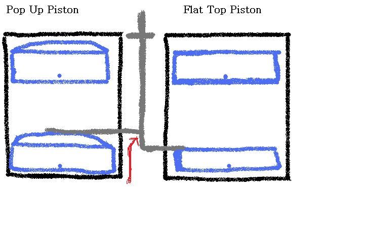

    You have half of the equation there, measuring to the top of the pistons at BDC. Now think about how you will measure to the top of the pistons at TDC.

    You're right I had a brain fart.

    Got the chance to measure it today. It's exactly 3.0" Then we piddled around with it and got it to run pretty good. It had been sitting since 02, and had never ran for more than a few seconds. We ran it for a good 3 minutes. Within that 3 minute span, it had already used half a gallon of gas, LOL. We unplugged the gas line, and dipped it in a one gallon jug. I'm sure the tank was full of rust and I didn't want to chance it. Here is a video I was able to take. It starts to warm up around the 1:00 mark. Valve covers are shot as you can see steam come out of the left one. I had that one off there a few days back. It was cracked and frayed. It's a work in progress. Hopefully it will be transferred to my '73 and on the road by this summer.
