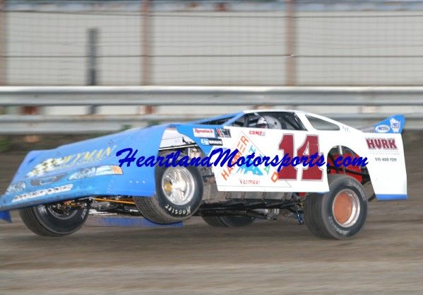

    We spent dyno time with a Yates headed, 364", 14.5:1, gas burning, roller cam, shaft rocker, dry sump engine on a Wix, K&N and the R2C. Dropped Base, 14x4 filters with a domed lid.
    A flat base air cleaner cost HP, the K&N cost HP and won't seal as well to the filter housing, the Wix did a decent job but the R2C killed them all.
    For those that think there is nothing to gain, on the above engine we picked up 24 HP in one day messing with spacers and filters. That's 24 HP on a 635HP engine with the best stuff available at the time.
    There are gains to be had, if you are willing to spend the time (and money) to find them. We also dyno tested an IMCA dirt late model spec engine (basically a Brodix Track 1 head with the same internal components as the open Yates motor) and gained more. In fact they eventually enacted a spacer rule to negate what we had found. A simple 4 hole 1" spacer was worth 15HP. Some as much as 25. That's huge on a spec engine putting out 535HP.
    If you run in a dusty environment at all, spend the money for an R2C filter. Put it in a sure seal housing and play with some spacers.
    That's a dirt late model with the above engine.

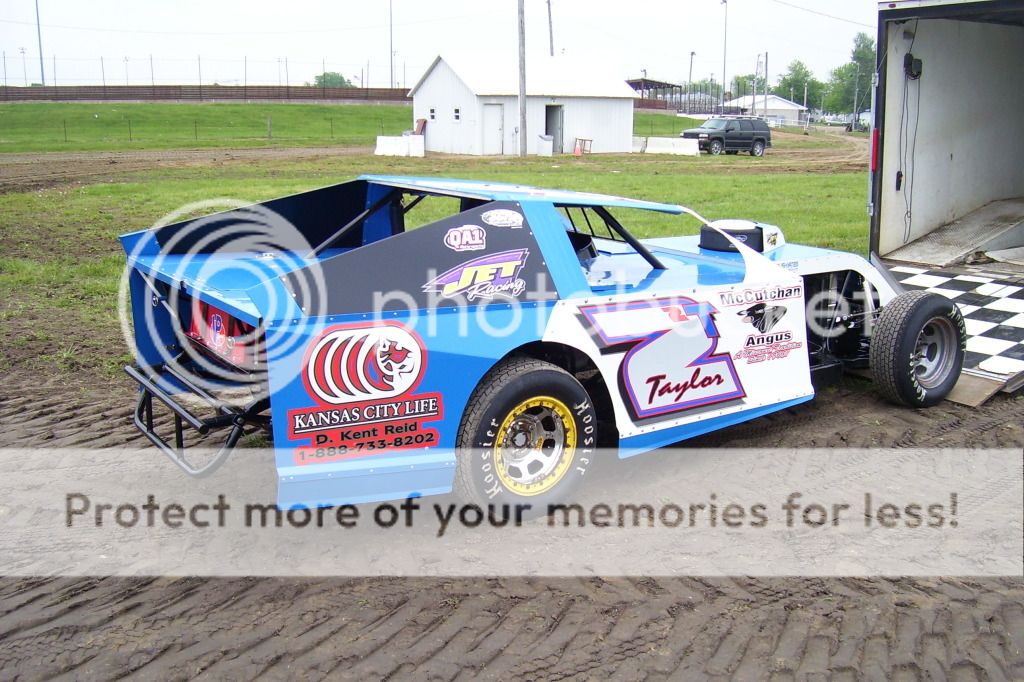

    We also ran them on our mods.
