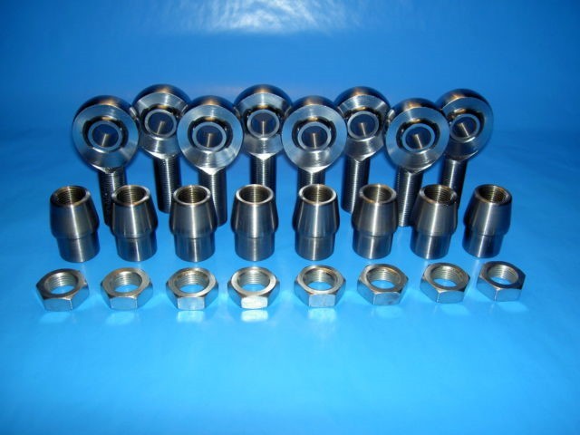

    Ordered my heim joints, and weld bungs.
    4-LINK KIT CONTENTS:
    • 4 RH 5/8-18 THREAD, 1/2 BORE HOLE
    • 4 LH 5/8-18 THREAD, 1/2 BORE HOLE
    • 4 RH JAM NUTS
    • 4 LH JAM NUTS
    • 4 RH TUBE ADAPTERS
    • 4 LH TUBE ADAPTERS
    ROD END SPECS:
    • THREAD SIZE: 5/8-18
    • BORE: 1/2 (.500 )
    • BALL WIDTH: 5/8 (.625 )
    • RADIAL LOAD: 31,300 lbs
    • CHROMOLY: 4130
    • TEFLON KEVLAR LINER
      • ( Increases wear & longevity )
    TUBE ADAPTER SPECS:
    • LENGTH: 1-3/4 (1.75)
    • WIDTH: 1-1/4 (1.25)
    • 5/8-18 THREAD WITH 1-1/4 OD x .120 WALL
      • ( Fits in 1-1/4 (1.25) outer diameter tube with (.120) wall thickness )
