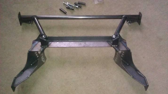

    Here is my AJE front end kit laid out.[​IMG]

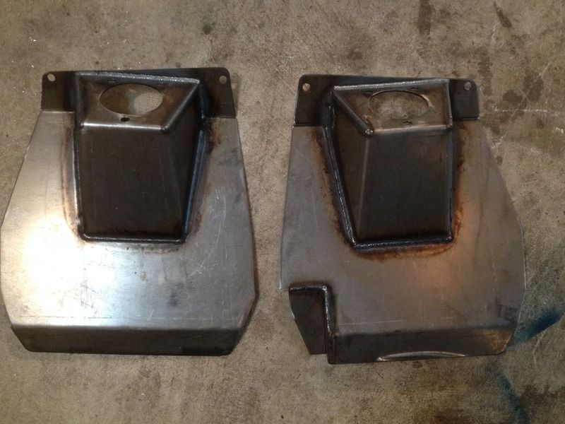

    Here are the mini shock towers[​IMG]

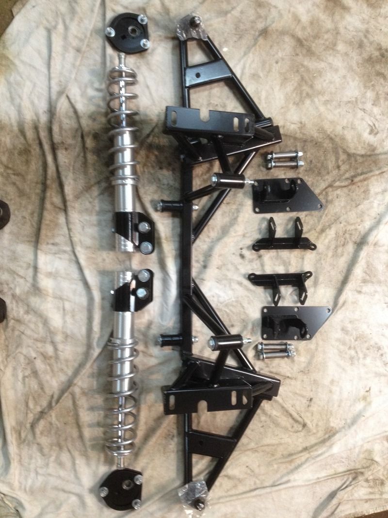

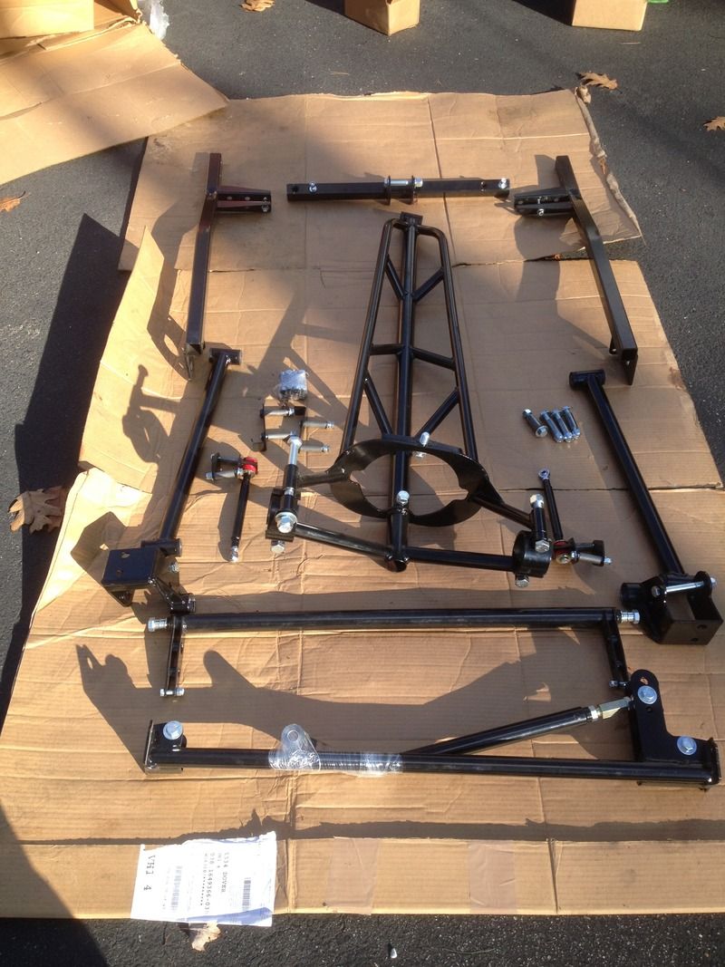

    Here is my AJE rear torque arm set up laid out. This removes the leaf springs.[​IMG]

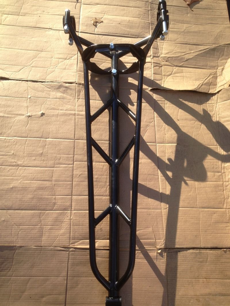

    Here is the pic of the AJE 64-70 Mustang rear subframe[​IMG]. Notice it does not look anything like Torque Arm set up. [​IMG]

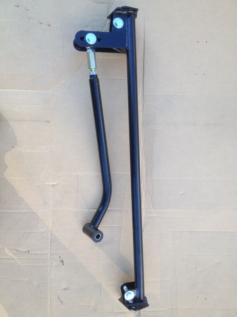

    50
    I will lay it out so people can see how the AJE Torque arm kit bolts in a Maverick with a Fox body 8.8. First here is the Torque arm that bolts (clamps) right on a Fox 8.8 rear. Also when you buy this kit you get subframe connectors in the deal! Which are bolt on too.(i'm welding all my stuff in) What's nice about this kit is you can dial in your pinion angle right on the torque arm and not mess with control arms to do this.
    Where you see the long bolt on right side of arm mount,that gets pushed to rear and then that mounts the fully adjustable panhard bar. The panhard bar is also the coilover upper shock mount.That also bolts into car.
    You can see the poly mount on one end this mounts to that long bolt I mentioned above.
