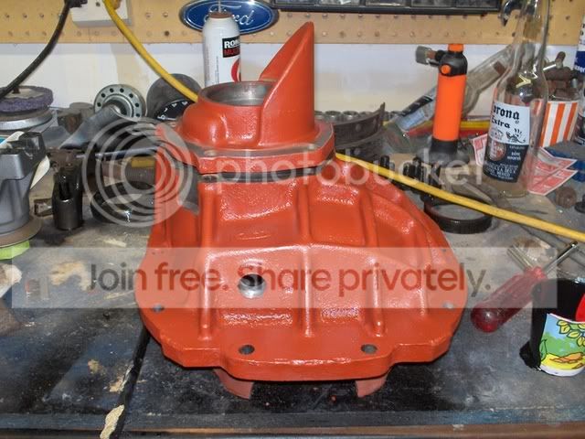

  3. Dave B
    What like this?
    As far as I could tell it was just some sorta red primer, I used red Rust Buster paint, if you want some I still have 3/4 of the can left that you could use. I doubt it'll rust, it's covered in oil on the inside.

    The pumpkin DID have remnants of that color on it, but the inside of the housing pot had stuff nearly the same color but mostly gone.
    [BTW I see some remnants of YOUR lubricant in the background there, Dave]
    BTW I'll take you up on that offer.....
